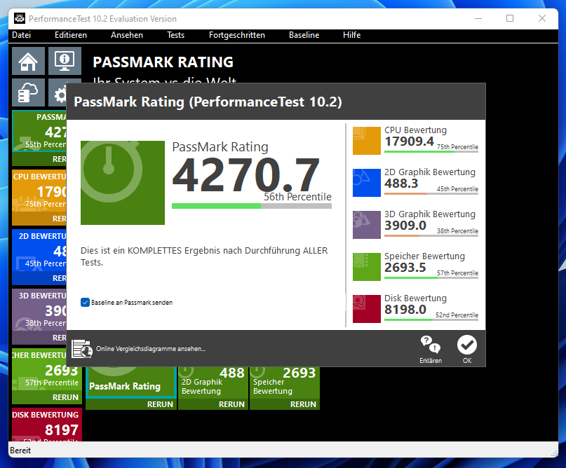

Then I installed PassMark 10.2 on both win11 instances. I let them run the benchmark in full screen mode and here is the result:
Windows 11 in Virtualbox:
win11-virtualbox
Windows11 in vmware:
win11-vmware
The difference is dramatic. vmware shows by far the better performance. virtualbox is slightly worse in CPU rating but a little better in memory rating. At the end of the day that seems to compensate each other so that the darktable benchmarks give similar results for both virtualization solutions.
The big difference is with the graphics performance and the disc performance. The virtualbox had 3D acceleration enabled. But still, it is far behind vmware, which had 3D acceleration enabled as well.

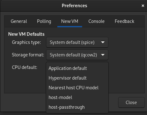

I have looked a bit at Qemu Wiki for how to configure CPUs for the VMs. Here is an excerpt
The goals are to maximise performance, while protecting guest OS against various CPU hardware flaws, and optionally enabling live migration between hosts with heterogeneous CPU models.
  • Host passthroughThis passes the host CPU model features, model, stepping, exactly to the guest. Note that KVM may filter out some host CPU model features if they cannot be supported with virtualization. Live migration is unsafe when this mode is used as libvirt / QEMU cannot guarantee a stable CPU is exposed to the guest across hosts. This is the recommended CPU to use, provided live migration is not required.
https://www.qemu.org/docs/master/system/qemu-cpu-models.html
qemu-cpu-default
Which CPU model do you use or recommend?

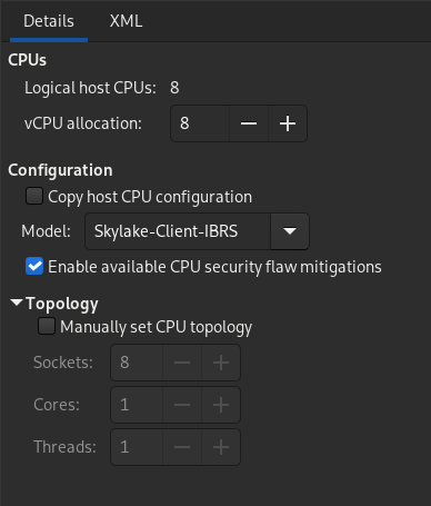

The picture below is from a VM I already created. Should I check the box for "Copy host CPU configuration?
cpu-config-qemu-host
