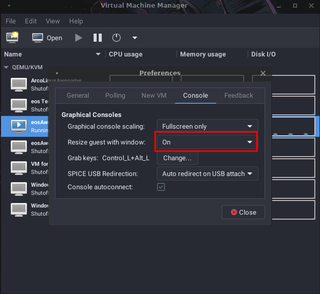

One thing I noticed, and there was talk about this in the other thread somewhere, that virt-manager wouldn’t scale the virtual machine resolution to fill the whole windows (in windowed mode). I also had this problem but only when I tested Budgie. On my KDE (endeavourOS) virtual machine scaling works automatically.
So I guess there is some kind of bug in Budgie and it seems same kind of bug is affecting XFCE (as far as I understoon from some arcticles).
Install spice-vdagent on your guest os. and then got to View → Preferences and turn resize guest with the window on.
Ah, so at the end the suggestion of @lunainvictum to install spice-vdagent to get the guest window properly resized works.
Thanks for confirming!
yeah noticed that i need to install that splice to the guest. But still it doesn’t work with xfce/budgie for some reason

Yep, it’s kind of similar to gust additions from VB. I forgot to add this as a step in my tutorial which I’ve corrected now.
