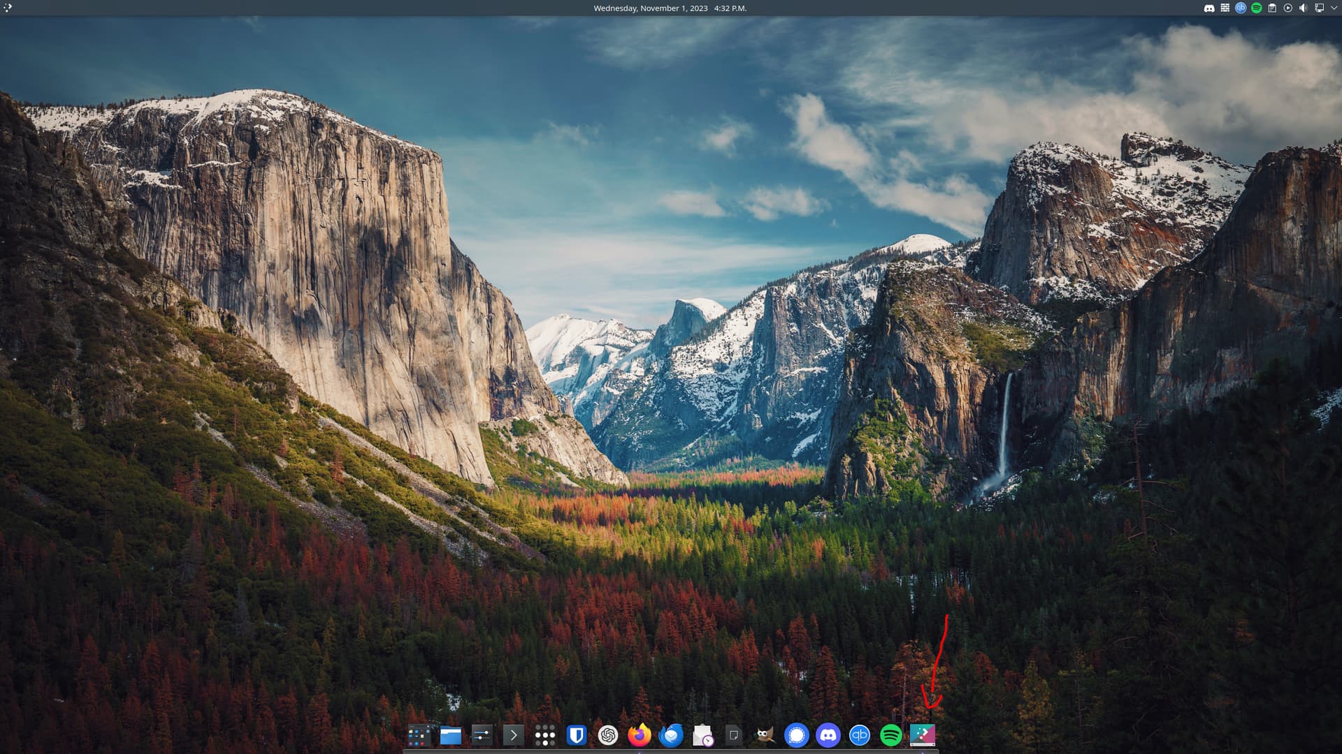

How do I stop this icon from appearing in plank dock?
As you can see in the screenshot below. The icon the red arrow is pointing to does not appear when I reboot my system. It shows up suddenly after certain applications are opened and cannot be removed. I drag it out of the plank dock, and it still remains. It’s the only application/icon that is doing this.
When I hover my mouse cursor over it, it says ‘Plasma Desktop Workspace’
How can I force this to stop appearing? My OCD is driving me up the wall :grin:

Yes very weird. I notice when I take a screenshot, the screenshot app summons it. The issue is, it doesn’t go away after it appears. It remains until the next system reboot. I also try to right-click it and click close, but it doesn’t close it.
