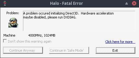

While I managed to install a game I get this error when I launch it:
I assume that wine is not able to get hardware acceleration working?
Edit: I ran winetricks dxdiag still didn’t work.
