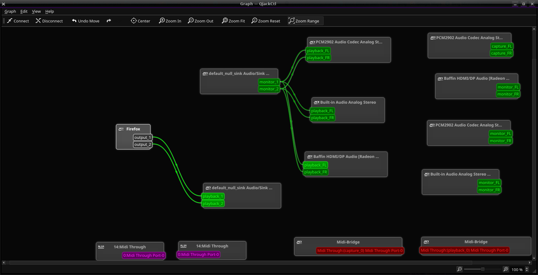

should look something like this but without null sink.
Screenshot_2021-12-29_20-05-45

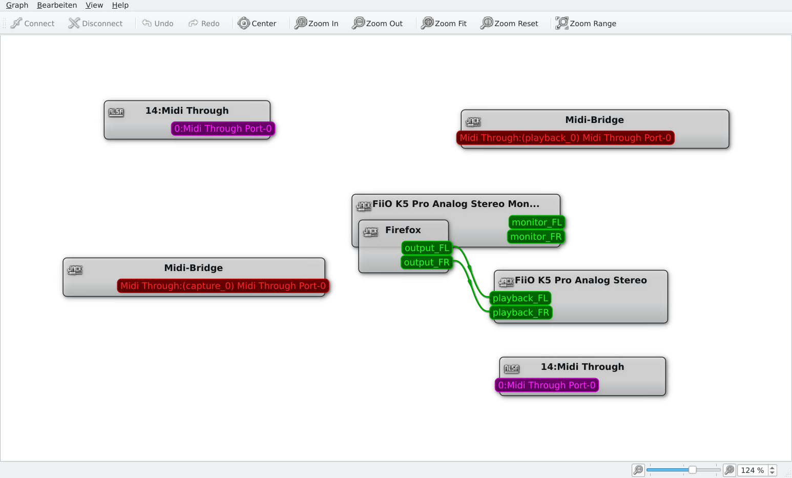

Yes, only Firefox and various midi codecs appear. no other open program, which I could connect to the DAC.
Hit the button that says zoom fit, if there’s another program that is sending audio, you should see it.
It should look like this.
Screenshot_2021-12-29_20-18-00
There’s nothing other:
Screenshot_20211230_021837
