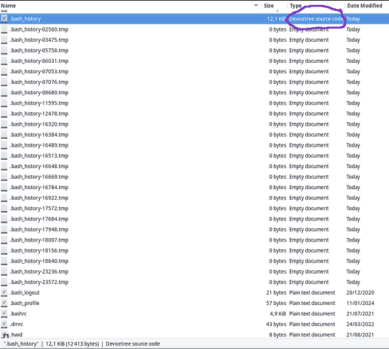

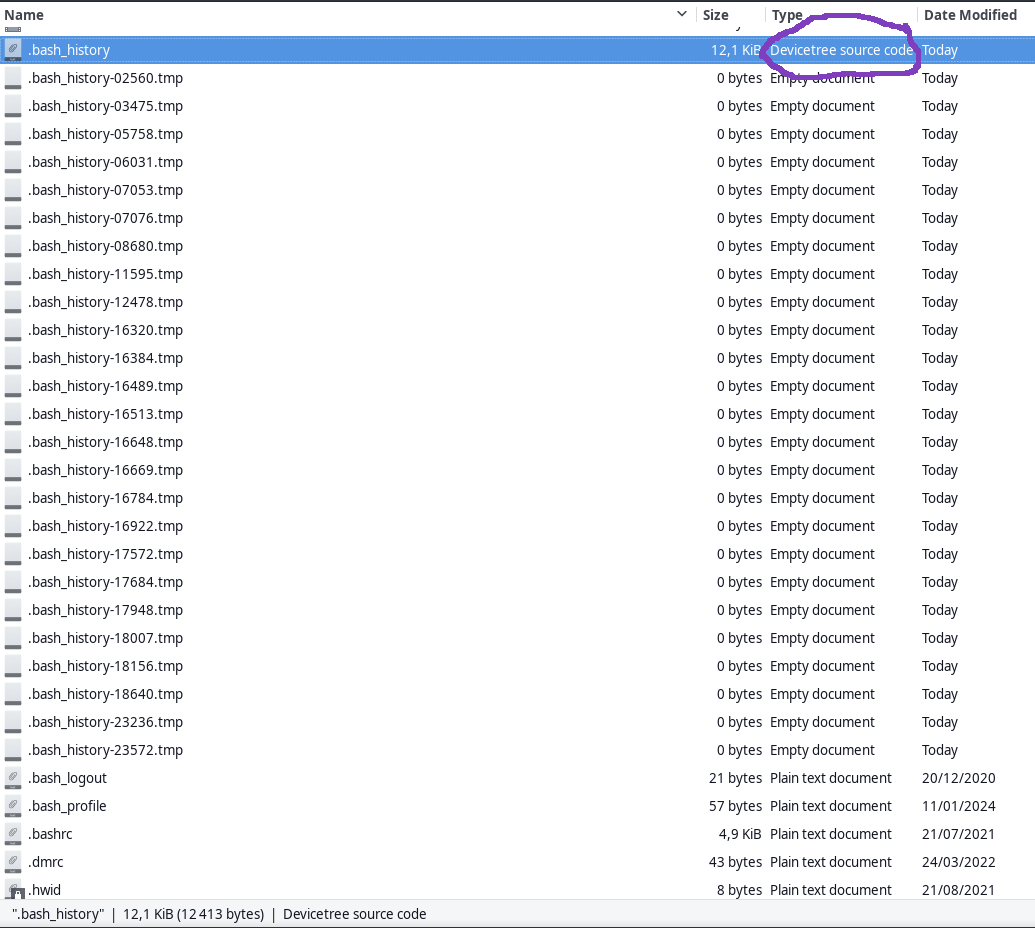

/home/user folder crowded with .bash_history-xxxxx.tmp

I was just “worrying” about that “bug” with the .bash_history.tmp
I guess my best move will be to erase those files and try to set whatever limit to the config and to see if they come back anytime soon (when the history is full?).
Do you think my ~/.bashrc “needs” any modification? (I assume at the moment it is used to show the welcome screen, print messages about updates, about arch news…and…stuff?)
I didn’t modify it and the .tmp files weren’t there before a couple of months (I guess…)
if there is nothing in bashrc that limits the history then bash will remember the history up to 500. After that bash continues to remember the history but in a tmp file as the bash history is already full.
That is why you see all those bashrc tmp files
So all you have to do is set some limit in bashrc (as all described in the link)

I wish I could have marked this tread as solved, but… still random (at least for me) creation of .bash_history-xxxxx.tmp (all empty this time, for the moment at least, before some did contain data) even after I took the steps @fred666 recommended… I rebooted a couple of times since then and all…

Well, if I open a terminal, type commands, do stuff, well, when I close it, most of the time (but not each time), one (empty) .tmp file gets created…
if i look at the same time journalctl -f and dmesg -w nothing shows (although that might not be what to look at…), and the “system monitor” (glances, again that might not be what to look at?) shows lots of available memory, no particular process eating CPU resources…
.bash_history gets populated with the last commands…

Well if anyone has read the article and my comments why still trying to fix something that isn’t a problem if you set the limits you want is bashrc?
Due a change in bashrc this behaviour began and that is because there never is set a limit. Earlier bash didn’t complain about this but does now.
So set the limit and your done, no big deal
