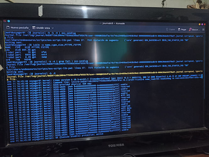

Hi, Im a basic user, yesterday my machine booted into emergency mode. Looking around I managed to “fix it”, I used fsck, rebooted and it got out of emergency mode. But now, as expected, it keep having some bugs, first the endeavour tools, launcher, apps info, logs tool, update, reflector, wont open, either clicking it or launching from terminal. Second, Firefox is my main browser (Im writing from Chromium) and it also dont open at all, just crashes. From what I could figure it has some corrupted journal entries. Theres a way to fix it without having to reinstall?
Here’s some screens from the terminal, hope it helps to understand what’s going on, I tried the commands that you suggest to post log entries but I couldn’t manage to have it sent to the pastebin

It sounds like you have a bunch of filesystem corruption. This could mean something went wrong and the logical filesystem is a mess or it could mean the physical disk is failing.
