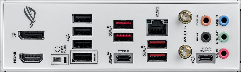

You have i9-10900K which does have Intel onboard graphics also. So you could try plugging the monitor into the output on the motherboard which i assume would be HDMI or display port instead of plugging it into your Nvidia card.
Edit: Your board has both HDMI and Display port.
