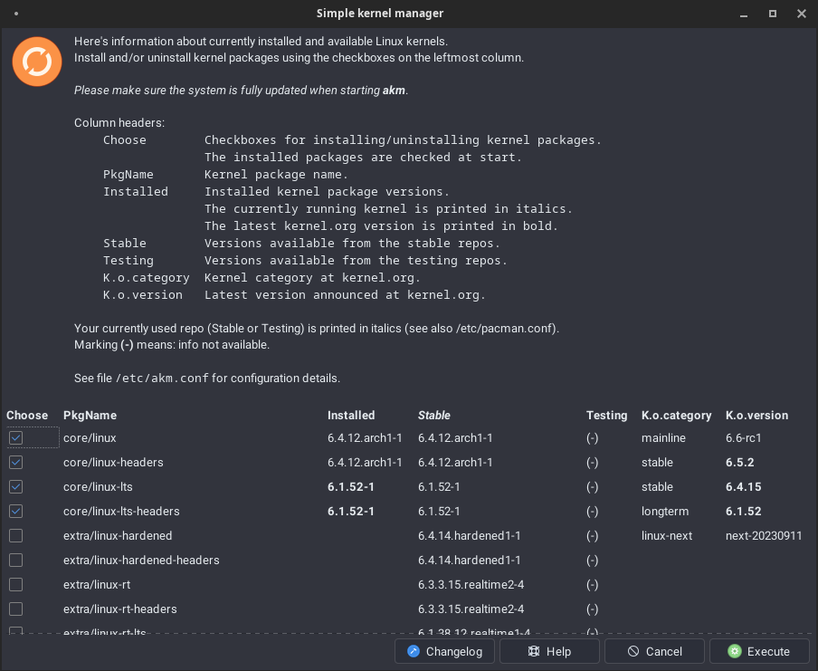

LTS Kernel is at 6.1, and my Arch Kernel was at 6.4 (now at 6.5 it doesn’t play nice with nVidia because I cannot install the 525 drivers via pacman, only the 535 ones which do not support GPU switching).
However, akm tells me that the KO version of LTS is 6.4, not 6.1. Is there a way to get the 6.4 lts?

That’s strange, Below is my AKM.
You always can use terminal to install it.
$ yay -S linux-lts linux-lts-headers && sudo grub-mkconfig -o /boot/grub/grub.cfg
Or you can break the command in to two.
$ sudo grub-mkconfig -o /boot/grub/grub.cfg
