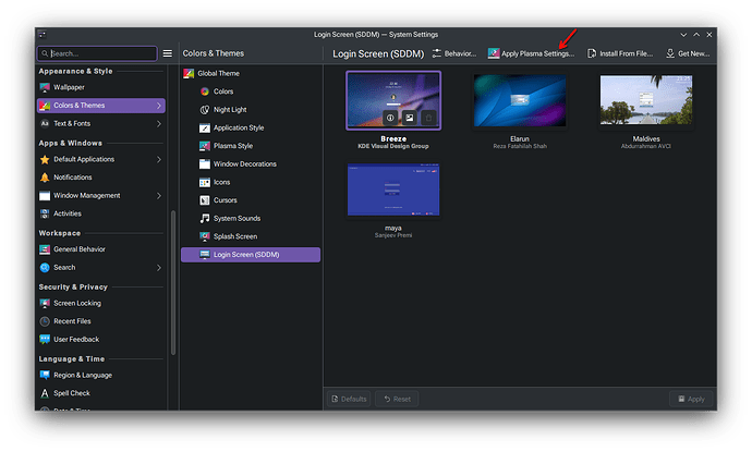

Ok, to address the rotation issue on the login screen, with your display setup correctly in a Wayland session (not X11), you might go to Login Screen (SDDM) settings, and hit Apply Plasma Settings…
Hopefully, your login screen should now be correctly orientated.
Does it have to be in wayland or can I do it from x11?
I’ll test that :wink:
Ah it says screen orientation only works in wayland
