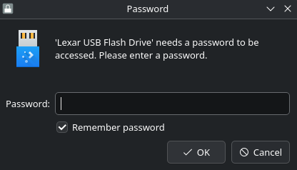

Using crypttab and fstab for the external drive may also be overkill. In KDE Plasma for example, when you access the encrypted drive, it’ll prompt you for the password and you can let the system remember it.
The KDE Plasma password prompt was what might pop-up if you don’t set up the USB drive in /etc/crypttab and /etc/fstab at all.

Otherwise, you could try commenting out any reference to the USB drive in /etc/crypttab and /etc/fstab and using the KDE Plasma “Remember password” option (assuming you’re using KDE Plasma).
