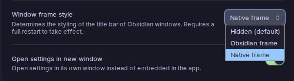

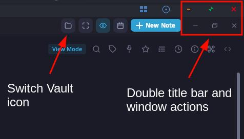

    • And for the main app window, the native window decorations are in addition to the app’s internal window decorations, which means you have two title bars with close, maximize, and minimize. See image below.
      • So the request here would be to merge the icons into the actual interface and removing the internal window actions buttons, like Obsidian gives you the option of doing. See the second image.
  • Deleting a vault on Linux also doesn’t have a confirmation dialog box.
  • Opening/Creating a new vault is more straightforward/obvious on Android, as you find it in General Settings. On Linux, there is only a little “Switch Vault” button that looks like a folder icon, and a user may never find this button.
    • I am not sure why the option isn’t also in General Settings, and/or the reverse - making the icon visible on Android. Also, the placement of the icon on Linux isn’t intuitive since it is only visible next to other icons that are specific to the current file being viewed or edited. Also visible in the image below.
Remove internal window decorations (example):

As far as the double title bar is concerned, and based on all the Tauri apps I’ve tested in the last few weeks, the title bar will never be native unless the app was built with a setting to turn off CSD. But, the double title bar can be fixed since only HelixNotes has displayed this behaviour.

If you are talking about the double title bar, again the only way for them to fix this is to have the application request that the window manager doesn’t display its native title bar. Another option is to redesign the app’s header so the minimise/maximise/close buttons are not baked into the header.
