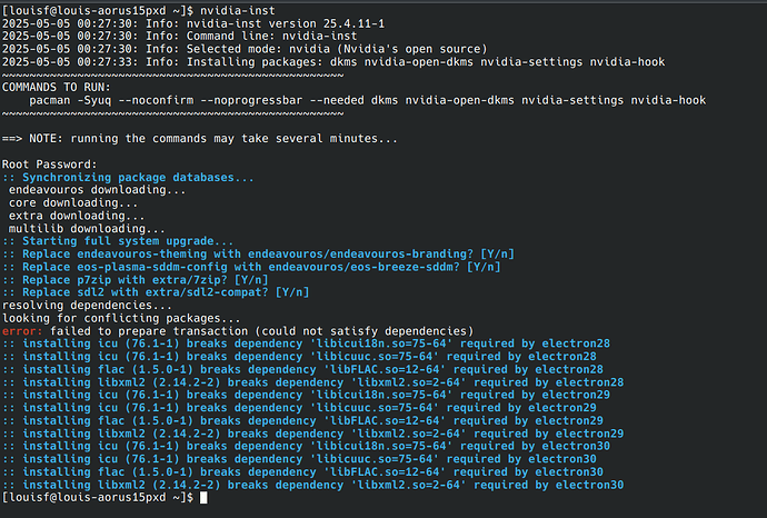

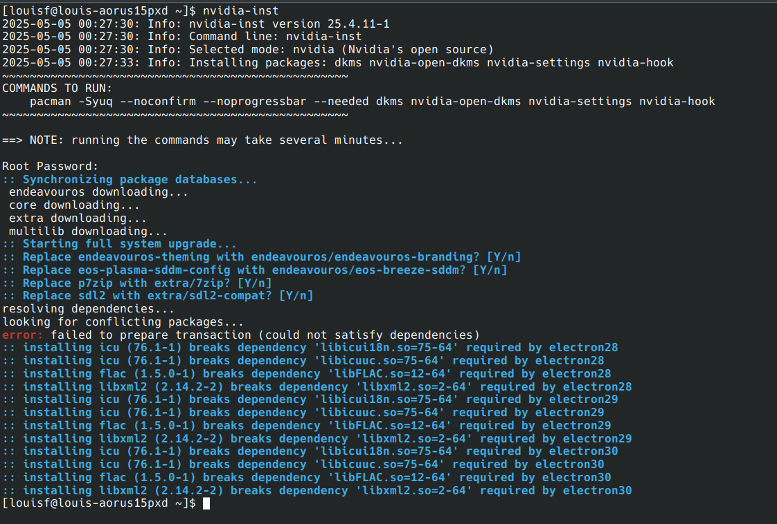

I’m sorry for the late response! I ended up focusing on some other stuff and haven’t used my laptop which has endeavour on it for a while. The output of the commands is as follows:
lib32-nvidia-utils 560.35.03-1
nvidia-inst 25.4.11-1
nvidia-utils 560.35.03-5
I also tried to use the nvidia-inst as I found in another thread and got some errors I’m not sure how to properly fix, did some quick googling but I have a feeling it’s likely the same issue as what I was having here. This was the outcome of that.
You should remove those old electronNN packages.
Tip: while uninstalling them, be sure to check that no other package needs the particular electronNN package.
