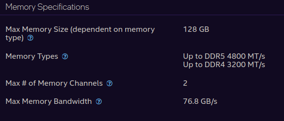

From the Intel site :
Memory Types
Up to DDR5 4800 MT/s
Not sure but maybe the I7 can’t handle the RAM one way or an other , might be worth to do some research on that I guess.

https://www.intel.com/content/www/us/en/products/sku/134595/intel-core-i712700kf-processor-25m-cache-up-to-5-00-ghz/specifications.html
That could definitely pose some diffugulties. Thanks.
RAM is passive. You can run faster RAM at lower speeds without issue. Most boards will do that by default.
Also, the stated supported memory speeds are almost always lower than the speeds most people run their memory at.
Incompatible part
Your memory module could be incompatible with your system. There are a lot of considerations when choosing the correct memory for your system, including memory type, speeds, densities, and more. To take the guesswork out of this, use the Crucial System Scanner or Crucial Advisor tool to find a guaranteed compatible upgrade.
This was taken from the site of Crucial , from the link I posted earlier, one of the things mentioned is speed. So this is a bit confusing if you ask me.
Just want to make sure I understand: If the CPU spec says it can only support only 4800 DDR5, it should be able to run 6000 DDR5 at 4800? The memory speed is a nonissue at the motherboard level.

Yes, you can run it at a slower speed.
Check your settings in the BIOS and see what speed it is set to now.
