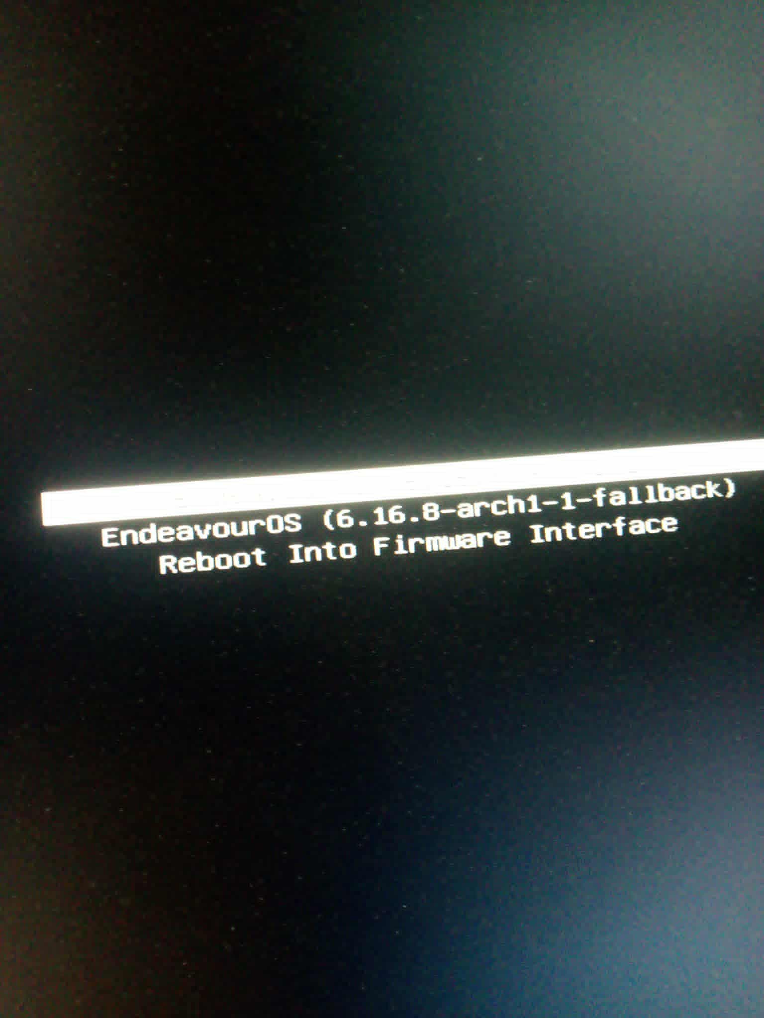

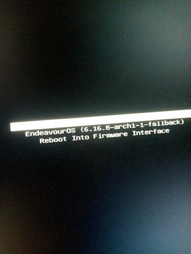

THEN I thought it must be the kernel that I just updated. So I try to run a previous kernel. BUT, I don’t see that option here:
There something I need to edit to allow it to use previous kernel versions?
Arch doesn’t keep a superseded version of a kernel after that it has been updated unlike, for example how Ubuntu does.
However, you can install other “lines” of kernels to have something to test.
There are four of them, I think, in Arch’s official repos:
https://wiki.archlinux.org/title/Kernel
So I can never go back a version? I thought with GRUB you could do that?
You cannot do that because the outdated version doesn’t exist in the system anymore. It has been overwritten by the new version. Therefore Grub doesn’t see it.
You could however “downgrade” your current one to the previous version.
You can use the downgrade program to go to a previous version of any package, but it should only be a temporary measure because you are then in partial upgrade state which is unsupported.
That looks not like GRUB as far as i can see, however the latest kernel is at 6.16.8-arch-2 now, just updated to it. Anyway any reason why you didn’t install this instead from the extra repo ?
You are right. That’s the boot menu for systemd-boot.

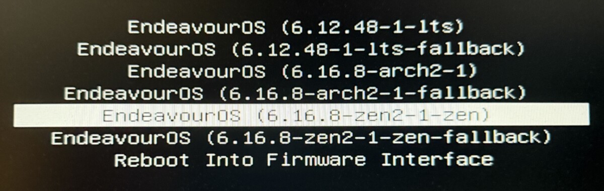

You could try installing and booting into another kernel. Zen kernel, perhaps? It’s available in the Arch Extra repo.
yay -S linux-zen linux-zen-headers
Yeah, but I do not know if it is the actual kernel. And what exactly is going on here. I thought a “previous kernel” would help it.
I hear ya. But, at least in my experience, it’s always good to have at least 1 extra kernel installed at all times.
I use ZEN, but if anything happens or an issue arises, I can boot into one of the other kernels and see if the issue exists there as well. This will tell me if the issue is related to a specific kernel, or something I need to diagnose further.
Well, with standard kernel, I don’t really have a choice, now do I?
Well there are standard Linux LTS Kernels that can be used along with the mainline Linux Kernel.
Then there is a hardened Linux Kernel that can also be used along with the mainline Linux Kernel.
However if only the previous Mainline linux kernel will do then there is something called as Arch Linux Archive, which you can use. Go through the documentation. In this archive the mainline Linux Kernels kept under packages> l >linux.
