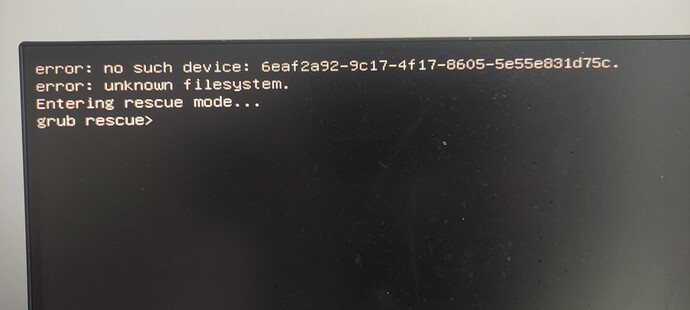

GRUB doesnt work correctly
What does this mean? :yawning_face:
Post something useful, image, whatever. :person_shrugging:
This Error showed up again instead of the GRUB menu.
Image.
Don’t cut/remove info.
Nice laptop.
The partition being searched looks strange.
Can you share the complete story of this laptop? Unless it is too private, of course.
What do you mean by ā€œstoryā€?
Forgive my English. I am not native speaker.
The UUID is not in the list you posted above.
The desktop PC looks like laptop.
You removed the UUID even from the 1st post, without some reason given.
I would assume you like to make fun with support volunteers.
Of course, I am wrong.
Now, can you give more details about the device and any other OS in the past, or… tell some story, whatever. :person_shrugging:

Me neither.
I did not know that the exact UUID is relevant I thought it was only important what it is from.
Yeah it kinda does on that picture.
Are you switching disks?
Are you using timeshift or other recovery app?
No.
What does that mean (my english isnt the best)?
This means if the UUIDs change between logs (they shouldn’t without a reason), it is next to impossible to help troubleshooting.
Note that you should provide us the information about the system status when we try to think what the problem might be.
They only changed once but that was because I reinstalled EOS.

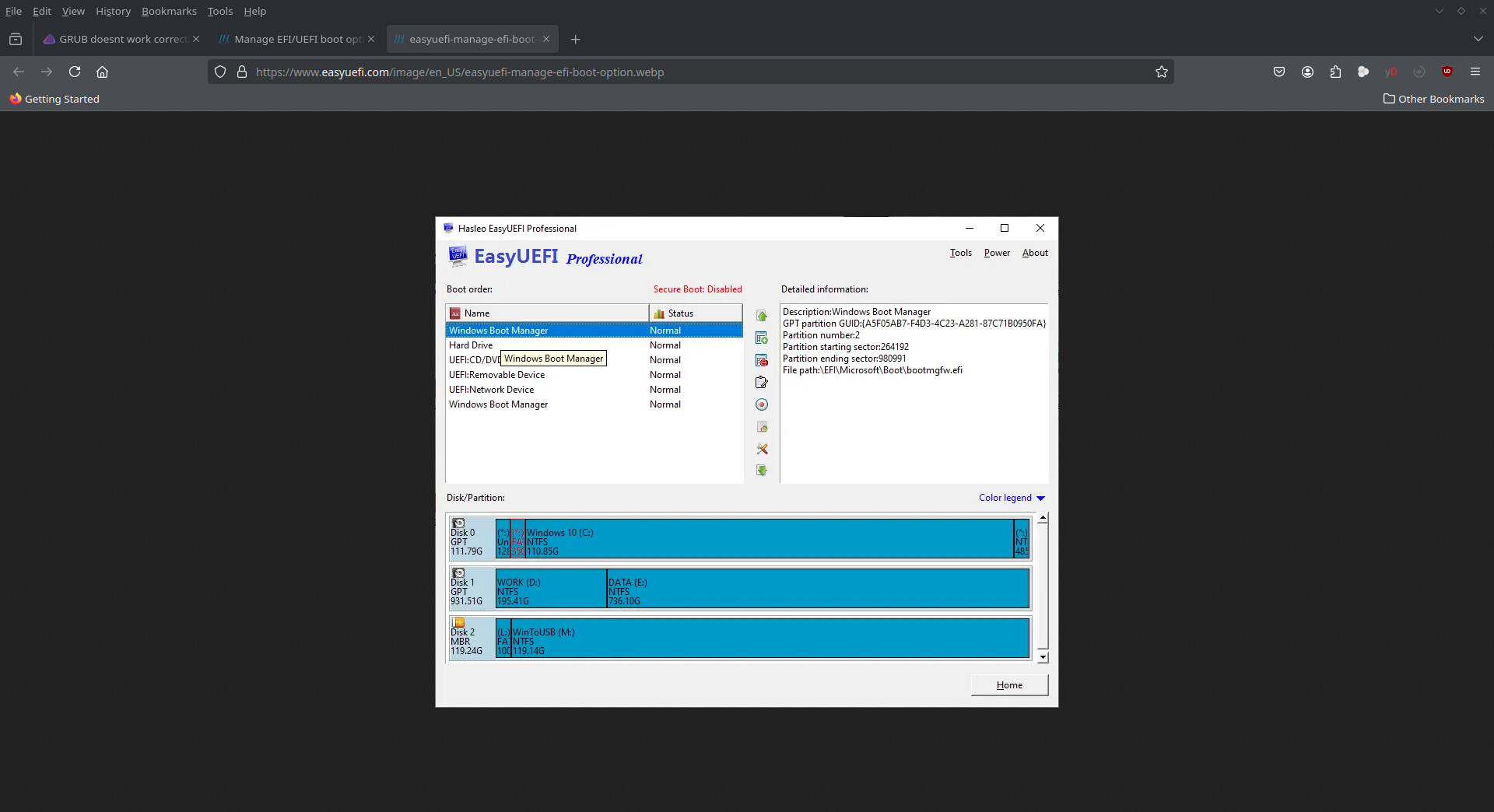

That is because probably you don’t have the correct entry selected to boot from. On my system you set the drive to boot from and then you select the proper entry to boot from that is in UEFI.
Edit: I realize you may not have these same settings since it’s an HP laptop. But there must be a drop down menu to select the entry you want to boot? It’s obviously not using that one when booting.
Maybe you should install Easy UEFI on Windows 11 and that will show you exactly what you have both graphically showing the drive partitions and also a description panel showing it.
Edit: Looks like this. Maybe it helps figure this out? :person_shrugging:
Edit: It may show more than one entry. :wink:
