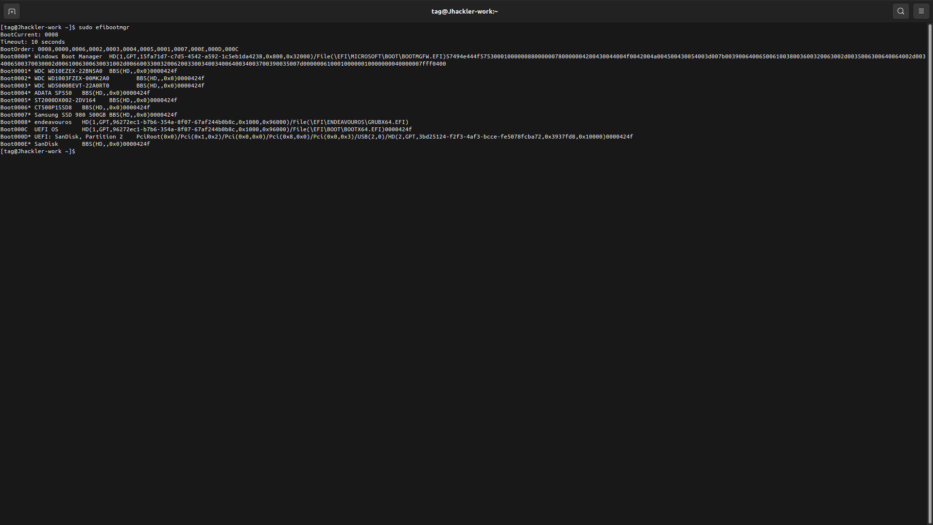

well so It takes multiple tries to boot now and there are 3 uefis on the same disk now and not even sure which one is correct lol. The one that is the first boot option in my bios seems to be the one that works but if I don’t manually select it it somehow doesn’t use it most the time. I don’t really know how to fix this all I did was run grub install a few times and the mk config thing till I got it to work without error lol
Try deleting the old entries using efibootmgr
some muloc grub errors have to set order in bios probably too
so to be clear its basically 3 separate grubs does this tool deal with that?
It lists all the uefi entries and lets you modify them. So…yes.
Screenshot from 2022-09-01 13-40-50
so in this example would I run efibootmgr -b C -B or which entries should be removed c has the name of the one that when manually selected drops to recovery 0008 is the current one that I have to manual select despite being first boot option which I thing would be efibootmgr -b 8 -B if I wanted to delete (which obviously I don’t)
sorry for the questions I haven’t dealt with many boot loader issues like this and don’t wanna break anything lol or maybe c is the one that does the non themed boot menu that doesnt work and 6 does the recovery lol
I think this is why its borked I feel like there should not be 2 other folders and I think the highlighted one on the right one but not sure
endeavouros is made by sudo grub-install , the other two can be removed ?
you did before the fix i believe… but did grub-install again, does it has the bootorder ?
otherwise select in bios that… and remove other two.
