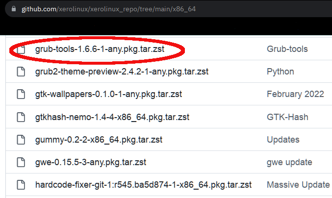

And look at what XeroLinux have in their repo:
xero
