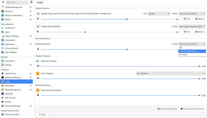

Good day guys,
I rarely use google meet but unfortunately with work I started to need it big time… I realise soon enough that my system do not recognise any of my headset…
I was able to get sounds though my headset to work by sectioning some random profile codec as this pic show:
But when I tried to have my microphone though my headset I can’t find it! As this screenshot show:

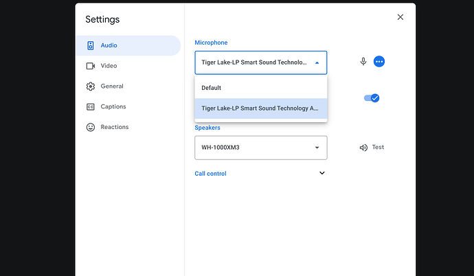

Do I miss any package that is needed to make my Bluetooth microphone/speaker work? Does not appear on google meet either:
Thanks for your time and help!

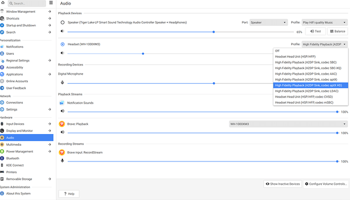

I think it depends on the app. For example, I have the Bose QC2 and it doesn’t show the microphone under the sound settings, but discord detects the mic and uses it just fine.
After doing some reading it seems you may manually need to select on of the HSP/HFP profiles and that will make the microphone appear in the sound settings. Maybe that will let Google Meet detect it. Although this does not appear to be necessary for Discord.
Correct that will make the microphone appear but the sounds will be gone… So now I got a microphone but I can’t hear anything haha
That’s weird sounds doesn’t disappear for me when I select either of the two headset profiles.
