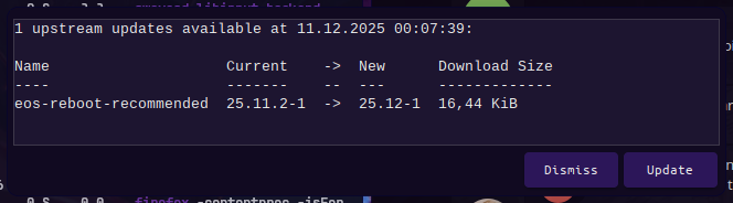

Getting error: command failed to execute correctly while Running post-transaction hooks
It was a pleasure working with you and Joe on this. Now I know a little bit more about post transaction processing. Thank you.
Went ahead and update to the latest package and then installed the Linux LTS Kernel and no errors were shown during the post transactions:
