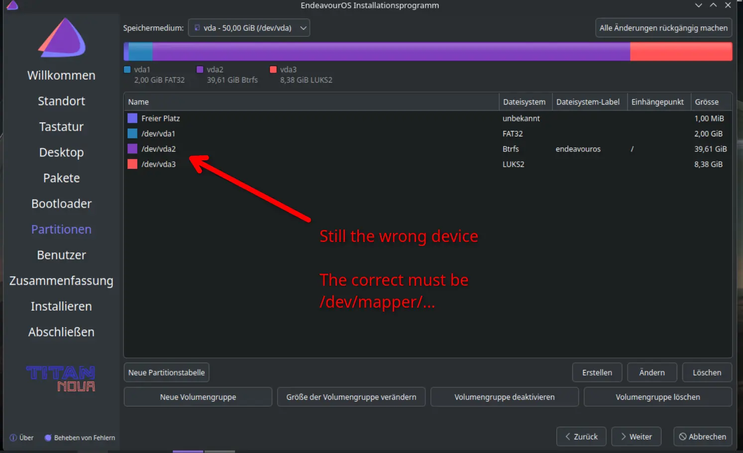

For better traceability, here are a few screenshots of the problem:

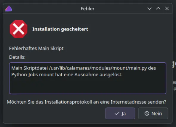

Here the calamaris Istall log:
https://termbin.com/p6qsq
Calamares::JobThread::run()
2026-08-29 - 14:41:39 [6]:     Starting job "mount" ( 7 / 40 )
2026-08-29 - 14:41:40 [6]: [PYTHON JOB]: Found gettext "de_DE" in "/usr/share/locale/de_DE"
2026-08-29 - 14:41:40 [6]:     .. Running QList("mount", "-t", "btrfs", "-o", "noatime,compress=zstd", "/dev/mapper/crypt_vda2", "/tmp/calamares-root-_5n8b5kn/")
2026-08-29 - 14:41:40 [6]:     .. Target cmd: QList("mount", "-t", "btrfs", "-o", "noatime,compress=zstd", "/dev/mapper/crypt_vda2", "/tmp/calamares-root-_5n8b5kn/") Exit code: 32 output:
mount: /tmp/calamares-root-_5n8b5kn: special device /dev/mapper/crypt_vda2 does not exist.
       dmesg(1) may have more information after failed mount system call.
2026-08-29 - 14:41:40 [6]:     .. Running QList("udevadm", "settle")
2026-08-29 - 14:41:40 [6]:     .. Running QList("sync")
2026-08-29 - 14:41:40 [2]: WARNING: [PYTHON JOB]: "Cannot mount /dev/mapper/crypt_vda2"
2026-08-29 - 14:41:40 [1]: virtual Calamares::JobResult Calamares::Python::Job::exec()
2026-08-29 - 14:41:40 [1]:     ERROR: Error while running: CalledProcessError: Command '['btrfs', 'subvolume', 'create', '/tmp/calamares-root-_5n8b5kn/@']' returned non-zero exit status 1.
At:
  /usr/lib/python3.14/subprocess.py(420): check_call
  /usr/lib/calamares/modules/mount/main.py(294): mount_partition
  /usr/lib/calamares/modules/mount/main.py(387): run
2026-08-29 - 14:41:40 [6]: virtual void
Is the part from log showing the issue.

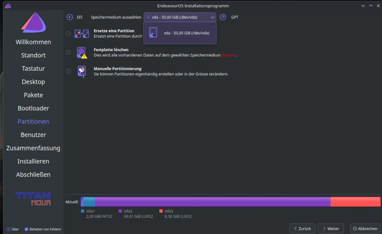

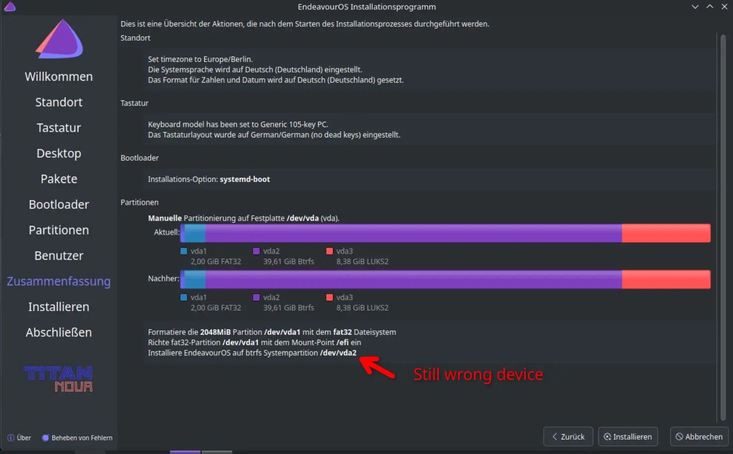

Yes, I saw that. I just don’t understand why calamaris cannot be mounted /dev/mapper/crypt_vga2 ; it definitely exists:
[root@EndeavourOS ~]# lsblk -f
NAME           FSTYPE      FSVER            LABEL       UUID                                 FSAVAIL FSUSE% MOUNTPOINTS
loop0          squashfs    4.0                                                                     0   100% /run/archiso/airootfs
sr0            iso9660     Joliet Extension EOS_202608  2026-08-15-14-13-08-00                     0   100% /run/archiso/bootmnt
vda
├─vda1         vfat        FAT32                        3824-B5A7
├─vda2         crypto_LUKS 2                            0ede1ab3-7ca3-4e09-b344-6a9f0c68f8a0
│ └─crypt_vda2 btrfs                        endeavouros 371723db-19c2-4814-8a55-77ad087d03a6
└─vda3         crypto_LUKS 2                            6fa459f4-bff3-46d1-8e47-fdeff5b2ec3d
ls -la /dev/mapper/crypt_vda2
lrwxrwxrwx 1 root root 7 Aug 29 16:42 /dev/mapper/crypt_vda2 -> ../dm-0
Manual mounting works without any problems, for example with:
mount /dev/mapper/crypt_vga2 /mnt
but that doesn’t help me because the installer wants to mount BTRFS in a temporary directory under /tmp, which changes every time.
Monitoring with dmesg also provided no new insights for me. The error must be caused by Calamares.
The only thing I was able to determine is that my manual mount is closed or no longer exists after Calamares has run and issued the error message. Something must be happening during the installation process that closes the mount beforehand, which then leads to the error.

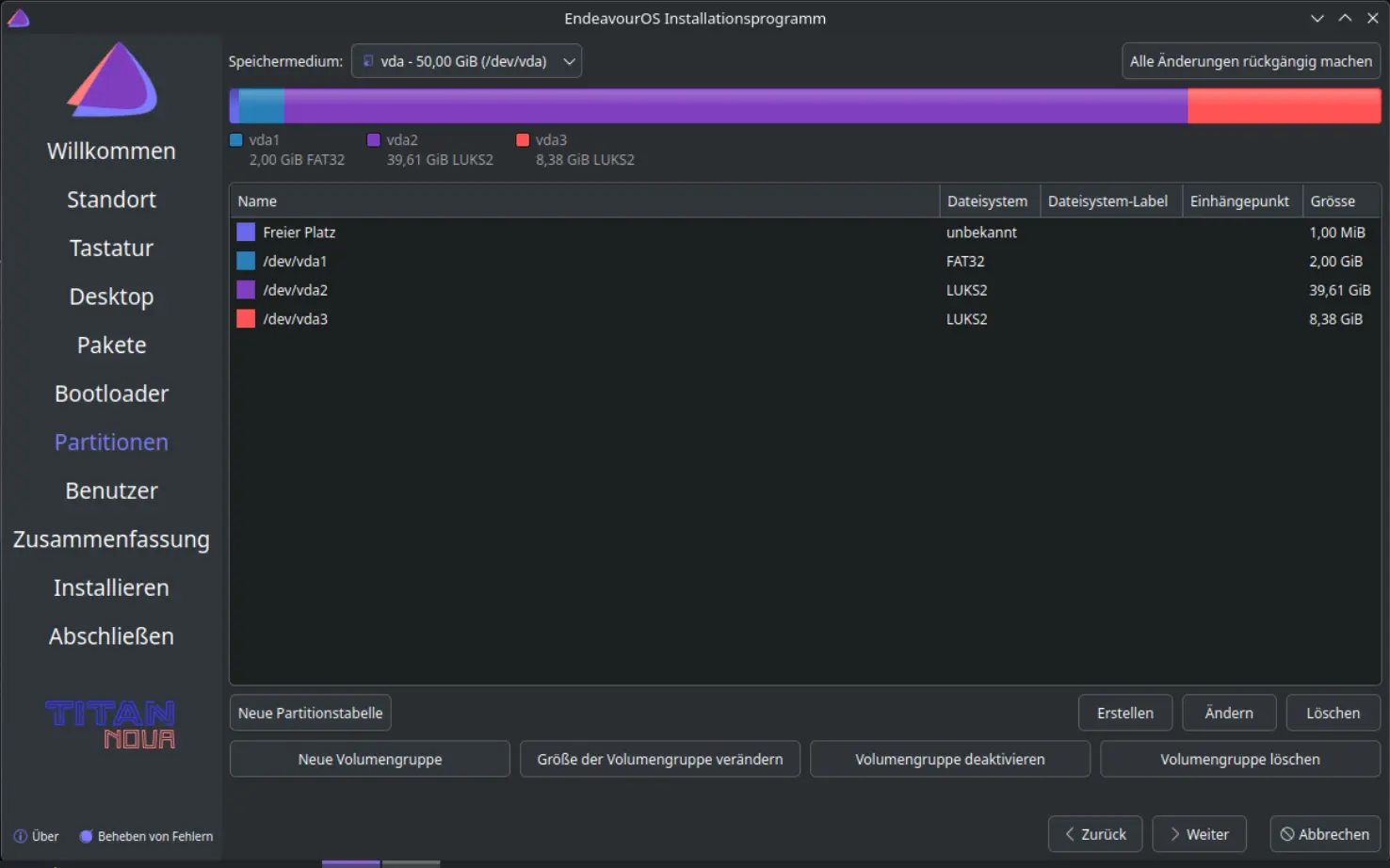

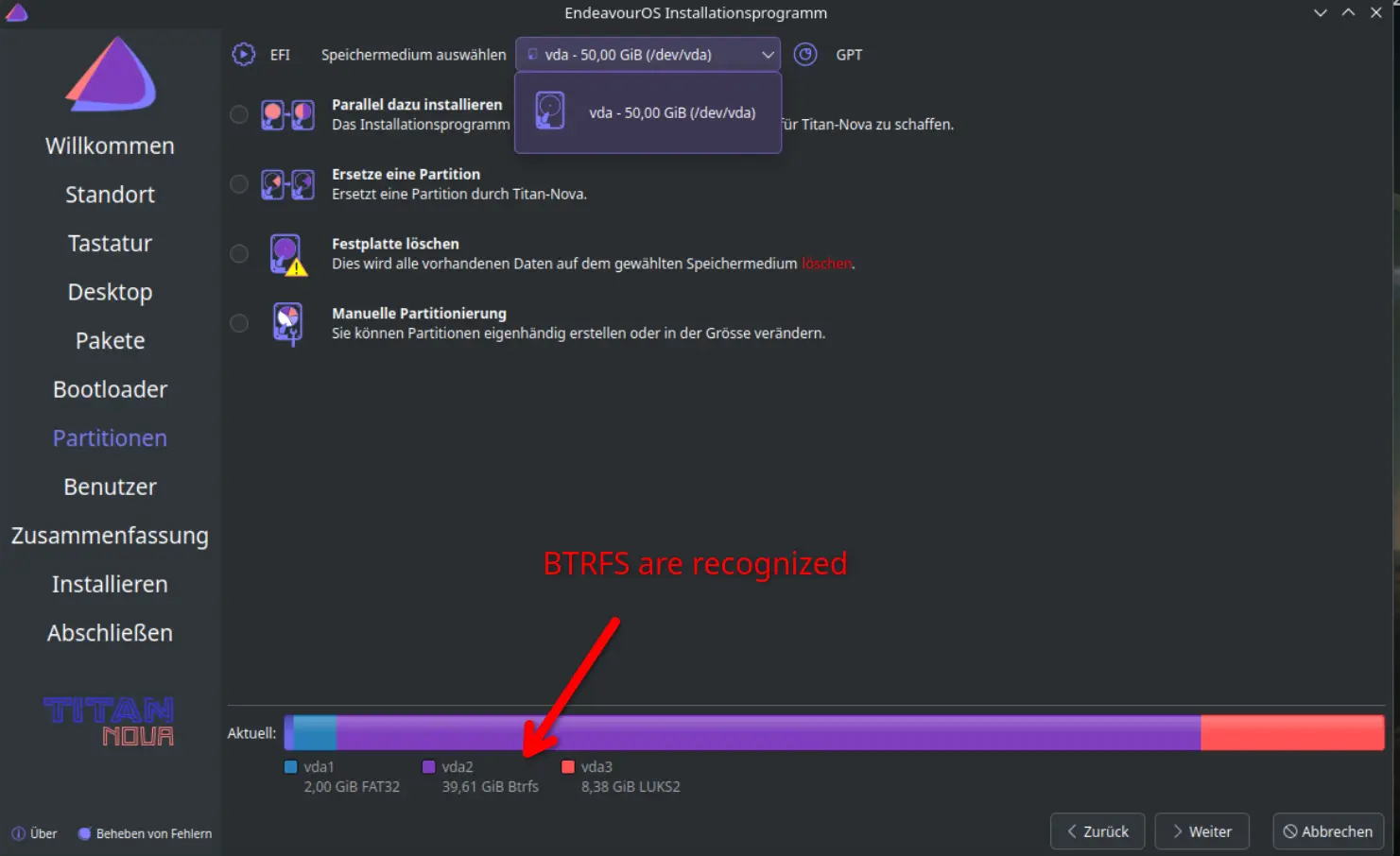

However, if I don’t mount it manually beforehand, Calamares does not recognize the BTRFS within the LUKS volume and only offers to overwrite the LUKS volume.
Sorry, let me correct myself. I didn’t mean mounting; what I meant is that if I don’t manually open the LUKS2 volume beforehand, the Calamares installer does not recognize the BTRFS. And as soon as the installation begins, Calamares apparently closes the LUKS2 volume during the process, because after the error message, the LUKS2 volume is closed again.
I found the moment in the log where Calamares closes the LUKS2 volume again.
2026-08-29 - 14:41:37 [6]: virtual void Calamares::JobThread::run()
2026-08-29 - 14:41:37 [6]:     Starting job "Löse alle temporären mounts" ( 2 / 40 )
2026-08-29 - 14:41:37 [6]:     Starting job "Lösche Mount-Points für Partitionierungs Operation auf /dev/vda" ( 3 / 40 )
2026-08-29 - 14:41:37 [6]: QStringList getPartitionsForDevice(const QString&)
2026-08-29 - 14:41:37 [6]:     Reading from "/proc/partitions" looking for "vda"
2026-08-29 - 14:41:37 [6]: virtual Calamares::JobResult ClearMountsJob::exec()
2026-08-29 - 14:41:37 [6]:     ClearMountsJob finished. Here's what was done:
     "Mapper device /dev/mapper/crypt_vda2 erfolgreich geschlossen."
