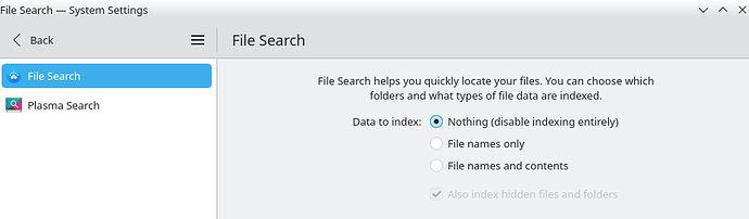

i would suggest exclude baloo fileindexer from indexing flatpak path:
balooctl6 config add excludeFolders $HOME/.var/
or if you do not need it disable it completely.
balooctl6 suspend
balooctl6 disable
journal shows issues indexing flatpak path, and this trillion times, that alone can cause crashes.

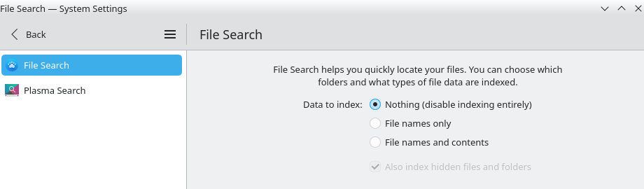

Is this the 1st journal or the latest one? Because I already disabled indexing through KDE settings, after it was suggested.
Or is balooctl6 a different index? Sorry if so. :frowning:
no no same same i mean baloo fileindexing, only wanted to mention that the issue alone could cause massive load on the CPU and other issues.

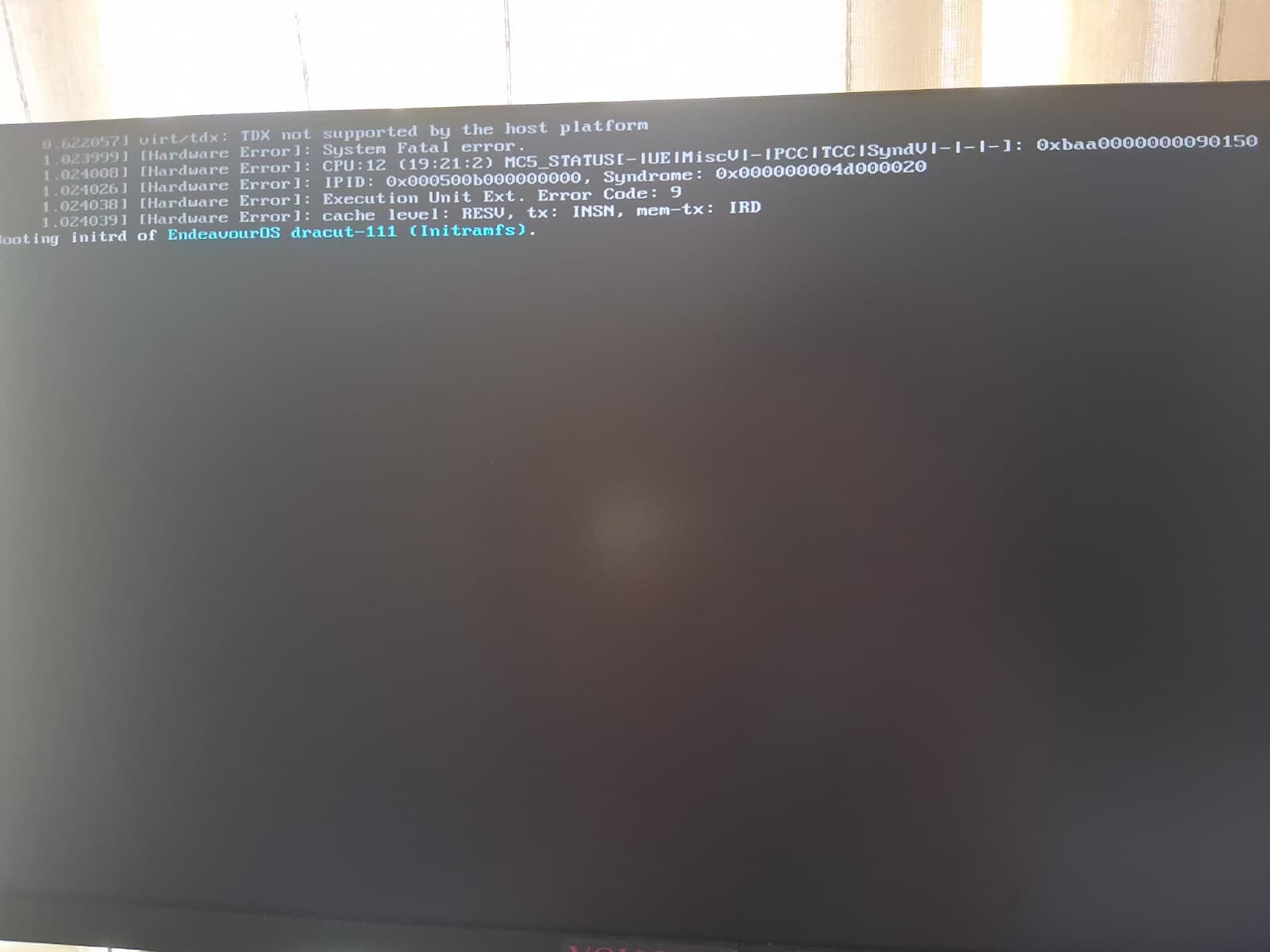

I managed to take a photo of today’s crash.
I believe it is a different one to the previous.
It’s occurred shortly after booting my computer and trying to play a game.
Any ideas?
What is your power supply? Make, model wattage?
Edit: Did you update the UEFI Bios to version 4201?
Ohh, I see they’ve released an update days ago.
I’ll try to tomorrow. Thanks!
I’ve installed it already. I also updated with fwupd after.
All pkgs both normal and flatpak are fully up to date. Man, I really hope this finally resolves it. The crashes corrupted my Armored Core VI save, so I lost 10 hours of my life and have to replay it all. :frowning: Even the Steam Cloud Save is corrupted. :frowning:
You’re the MVP to spot the new bios update, @ricklinux ଘ(੭*ˊᵕˋ)੭* ̀ˋ
