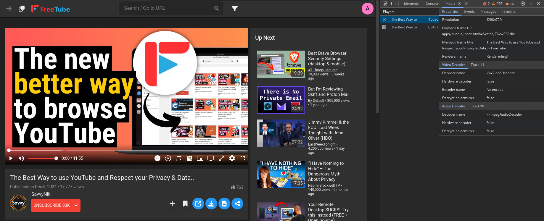

How did you figure out that FreeTubeApp is not using Hardware acceleration?
Being an Electron-based app it runs essentially on Chromium technology so you could press Fn12 to access the DevTools.
Once there, click on the kebab menu, more tools, media. Look under Video Decoder.
On my end it says: Hardware decoder false.
