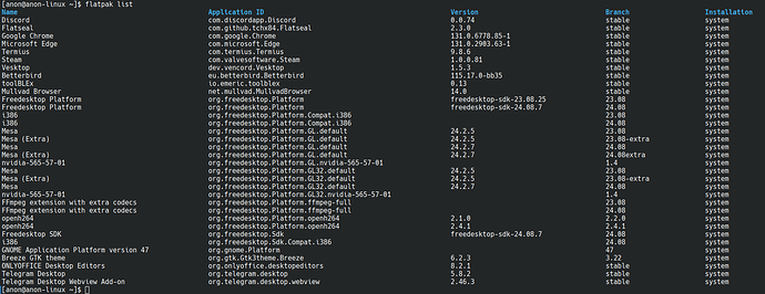

Can you share what flatpaks you have installed?
You can run flatpak list
I added a screenshot of the output from flatpak list:

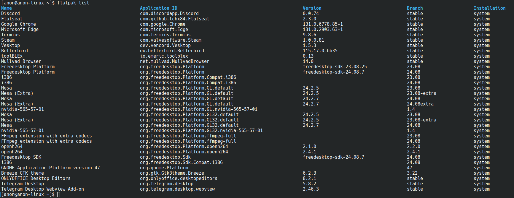

I don’t know what happened, but i re-run flatpak update to take a screenshot for the answer.

you have 100 entries which means you have 3 actual packages since 40 things attach themself to each package (all hyperbole but true nonetheless). this company is going bats*** crazy with the freedesktop stuff…I have 3 packages and multiple freedesktop stuffs get updated almost daily…
in fact my flatpak life has gotten 10X more bloated and 10X busier and I have no idea what is going on in Flathub world since I don’t follow everything but this has mostly nothing to do with your issue since I digress…
