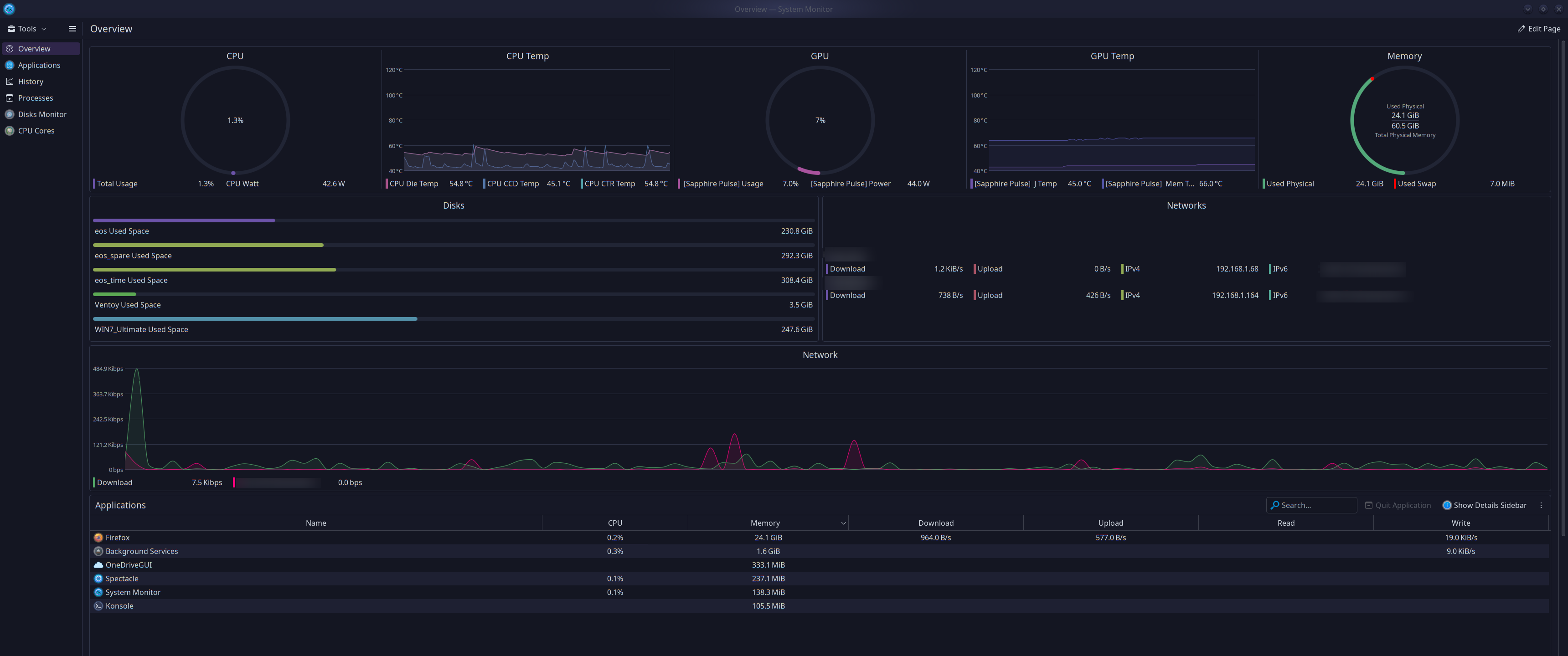

Firefox is swimming in a 24GB of RAM
Oooh Ahhh. Firefox is swimming in a 24GB of RAM.

What app are you using to display the above summary.
Pudge

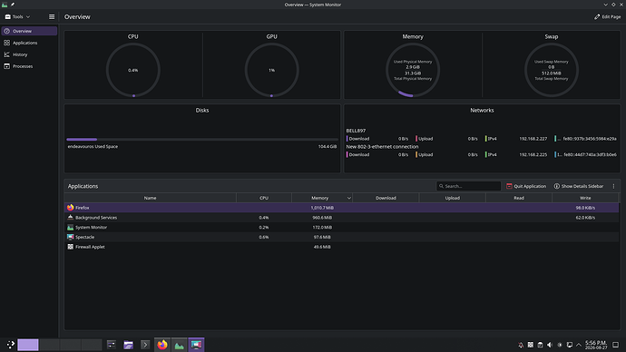

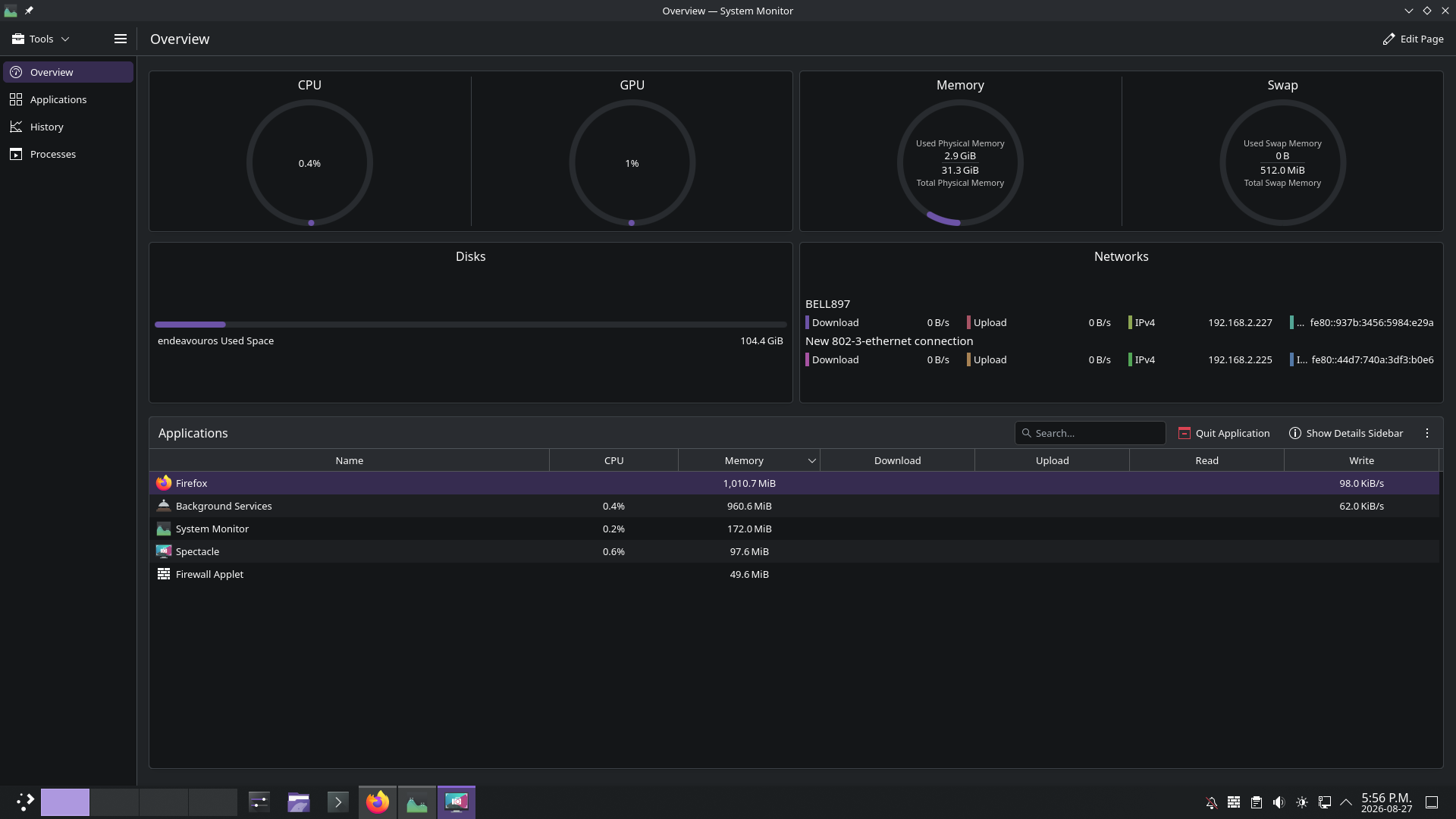

Standard KDE Plasma System Monitor
With firefox having group of tabs, and with 64GB of RAM, I let Firefox be a central data vacuuming and presentation system

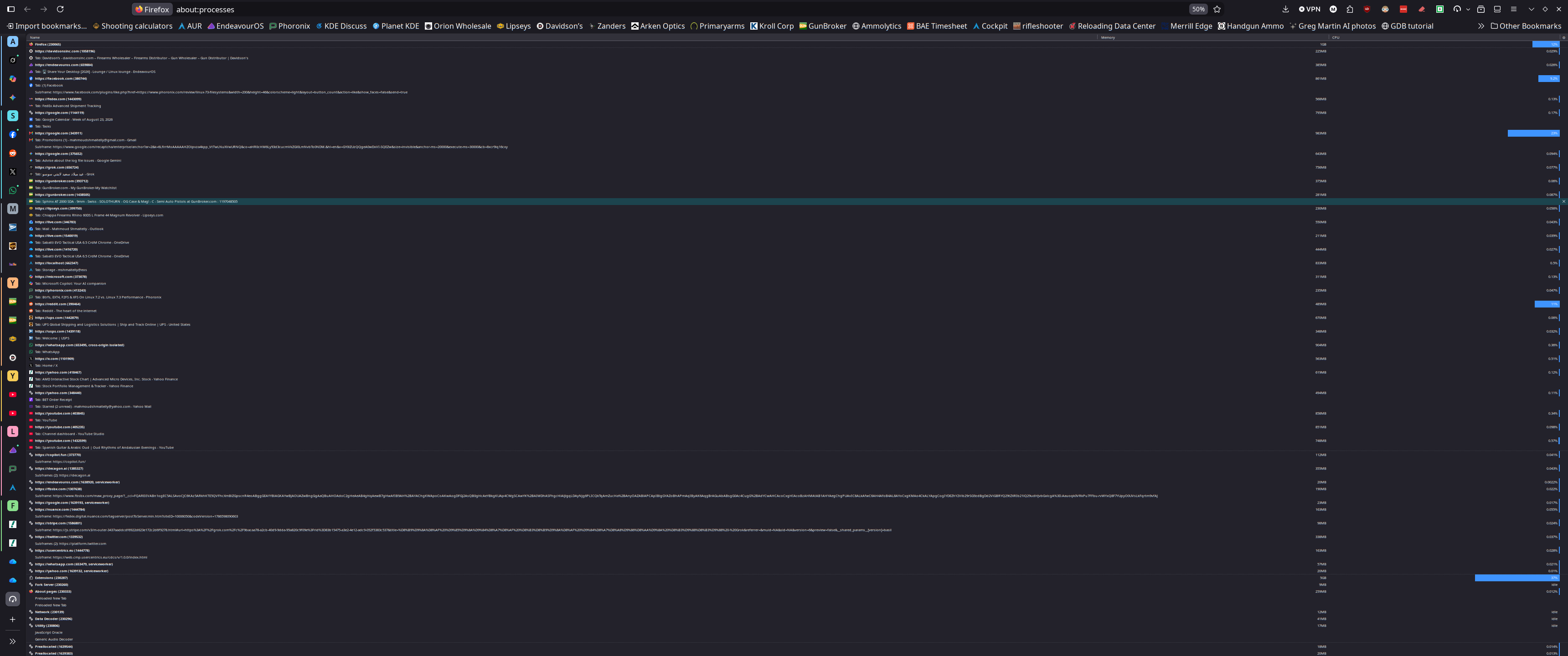

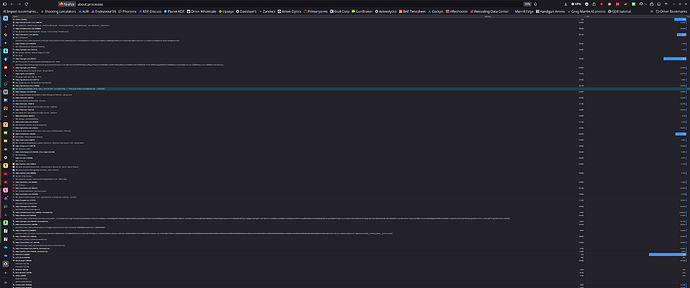

Here is the firefox task manager
with this configuration–if this is the first time its’ gobbled anywhere near 24GB–extensions would be my guess too. If it’s every day my answer would shift to hardware.
Unless it’s the famous FF settings ‘acceleration’ dealio?
PS–I could open your picture in a new tab but I couldn’t ctrl+ it to a readable state so no opinion about your task manager
