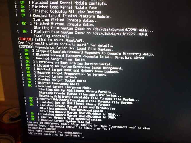

i have no idea what im doing, some time ago i tryed to update my sistem with yay and i think i closed the bash before it was finished whitch caused some problems like kernel panic with the msg failed to find linux.img (im not sure anymore) and it that time i was afraid of the forums so i used chatgpt with the arch linux bot thing, and it fixed it but today after another yay update another problem came up and it said that it failed to mount, im using a live eos usb and i dont have windows installed if this info helps

yes i am, before the emergency mode, grub opens up and after i select eos to boot if give the black screen with a bunch of OKs and a single failed which is the failed to mount thing
here is an img i found here on the forums but its exactly the same
