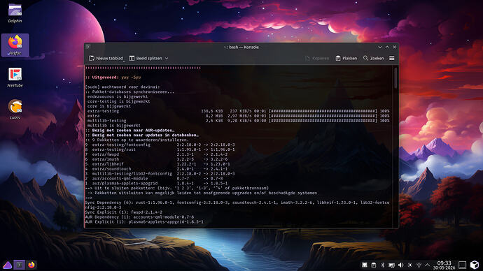

ERROR: accounts-qml-module is not available for the 'aarch64' architecture
I am trying to run yay and encounter the following error.
ERROR: accounts-qml-module is not available for the ‘aarch64’ architecture. exit status 12

Actually it is not required by any proram. I don’t kow why it get installed in the first place.
I will remove it.
Seems it got re-added in the AUR.
I also was surprised yesterday, cause the regular system update wanted to install this from the AUR. After checking, it had no dependencies currently connected to it. So I just removed it.
It seems to be connected the purpose package which again is related to some KDE git stuff.
yay -Rsn accounts-qml-module
… did the job for me.
Til now everything seem to work as usual.
