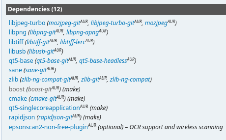

The naintainer of the AUR package would need to deal with it if tha’s the issue. Did you look at the package build to see what boost version it is using?

All I can find is boost.
It’s the git version using boost 1.85.0.r103.gf4d80a8776-3

I tried to install boost-git 1.85 but it gave me an install error.
