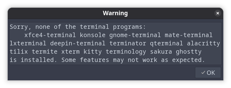

This is the result. For now, I am keeping gnome-terminal to avoid problems.
That’s just a warning, it may still work absolutely fine. It’s worth testing and if so, foot can be added to the supported list of terminal emulators.
The output seems strange. Did foot terminal work?

:slightly_smiling_face: It’s been resolved thanks to your questions, which I will answer so that everything is clear.
foot works perfectly
I typed it into the terminal and tried again, but it didn’t seem to work, probably because I didn’t do something.
I use bash. I want to learn how to use scripts properly and I don’t want to get confused with others.
Yes, my system is updated, I come from pure Arch and I have a habit of updating at least once a week or before installing or removing something.
Of course, when I looked at it, I found the solution by uncommenting the line EOS_YAD_TERMINAL and replacing the terminal. por foot

when ‘yad’ might be needed but is not installed.
EOS_YAD_MISSING_NOTIFICATION=yes
I’m not closing the thread because I’m not sure whether it’s appropriate or not, but for me this is settled.
Thank you very much for your help. With Coass, I am sure that one day I will be able to contribute something to this community.
OK, thanks.
Now I can add foot as one more supported terminal in the list.
