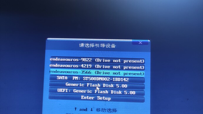

No matter how I tried, it will eventually become like this, I am using the offline version, I tried to install on the basis of win7, can display the system, but the brackets inside the display is not successful
Try “UEFI: Generic Flash Disk”.
It says the drive is not present, so it seems like it is a previous entry not being removed.

From the image of the Boot selection menu, it seems it is a UEFI system.
