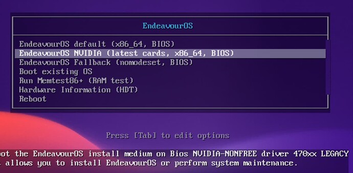

There you have it in case you want to try:
EndeavourOS-Nvidia-Legacy-ISO
You have to use the Nvidia boot option (also it says ā€œlatestā€ cards.
If it works for you to reach graphical live session, only offline install will work.

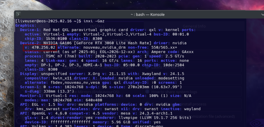

Thank you so much friend! This made my system to actually boot into the live environment, and after loading initramfs it only took about 1 minute to boot into the live environment, just as I suspected, this was a driver issue!
Thanks to you and other friends,
LL
It’s probably because it doesn’t like noveau and being an older gpu you need the 470.xx version drivers.
