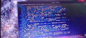

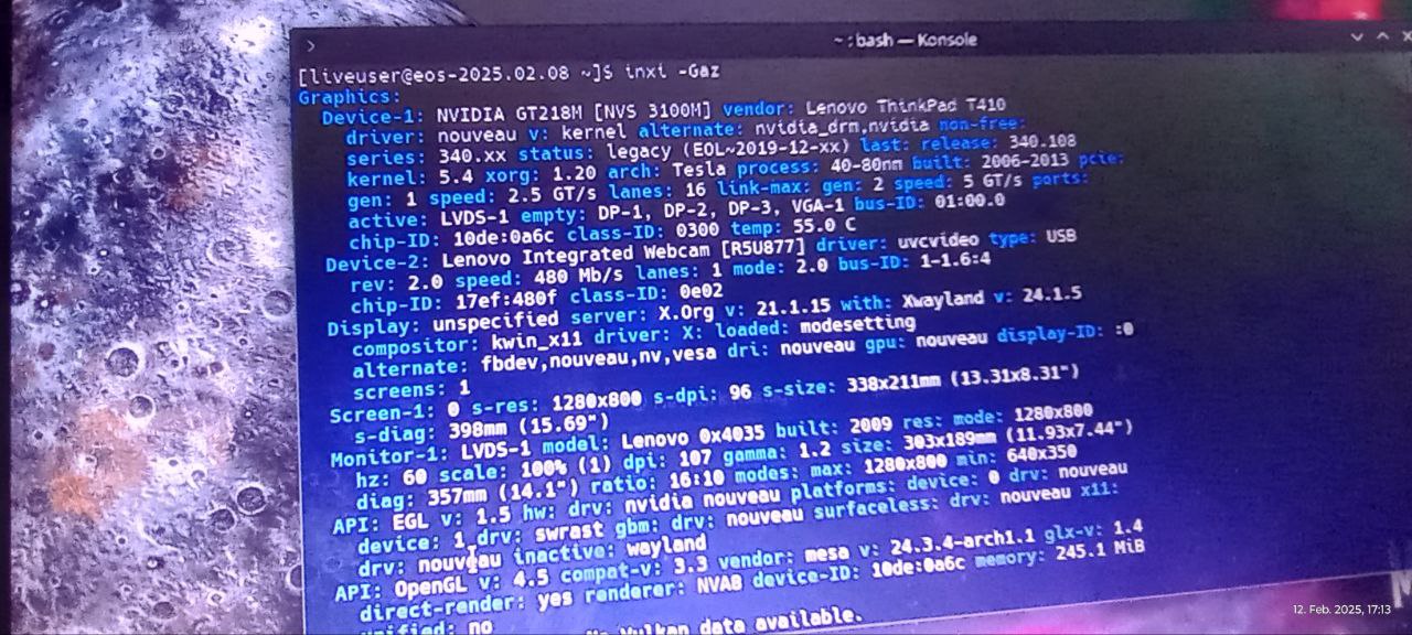

To make sure there is no general issue i just tried to boot on 3 different legacy machines here and all booting fine two of them using old nvidia GPU.
The default entry is blacklisting the new Nvidia Driver, and booting system using the in kernel nouveau driver properly.
