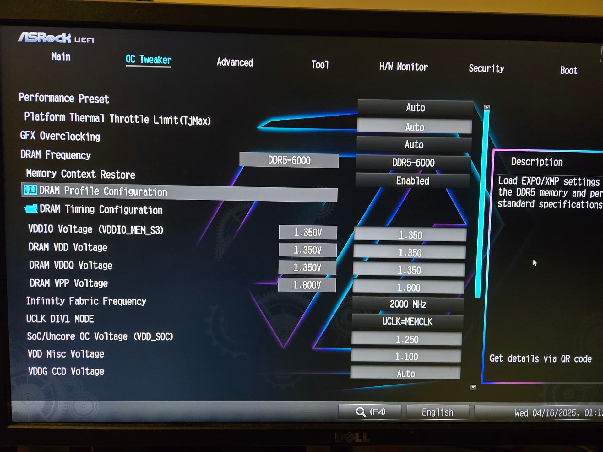

Perhaps check it. I recommend using the RAM’s built-in profile in the BIOS for now. It should be something like:
• EXPO Profile #0: DDR5-6000 CL36-38-38 @1.35V
Ya that does look low. I wouldn’t be using SPD but rather XMP profile at 1.35 Volts.
EXPO is just AMD’s version of Intel’s XMP.
I didn’t know that. :wink:
Edit: I guess this is because it’s an AM5 board which i haven’t had myself.
Yeah I was a late comer to that detail myself at one point :sweat_smile:
For a long time, I believed memory profiles were universally called “XMP”. It was only when I stumbled across “EXPO” I discovered it was an Intel thing.
I just checked the bios and it seems that’s the one that’s currently selected:

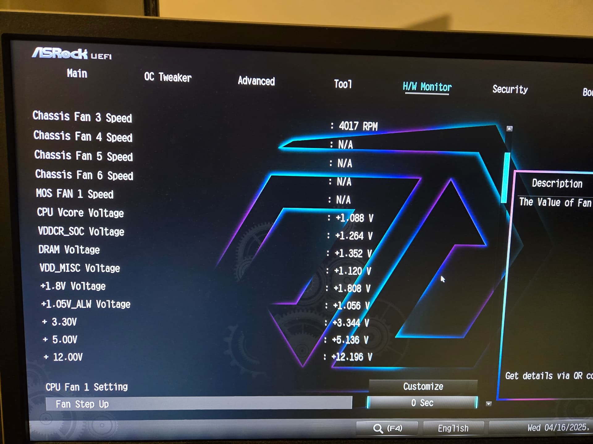

Also, looking in the H/W monitor tab, the voltage is showing around 1.35V:
So to confirm, it was found like that, no change was made I take it?
It was worth checking in any case. Have you approached the UEFI/BIOS update @ricklinux suggested?
Yes, no change was made, so I’m not sure why is the inxi command showing 1.1V :thinking:
