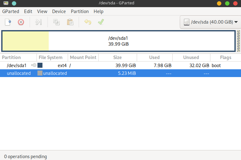

Edit: I am not sure of your process for installing it on vmware but there are two methods to installing in Bios actually 4 if you were dual booting with Windows on UEFI and using GUID partitioning. You said you didn’t use swap and only had a root partition. In that case your partitioning scheme would look like this.
Drives:
Local Storage: total: 18 GiB used: 6.06 GiB (33.6%)
ID-1: /dev/sda maj-min: 8:0 vendor: VMware model: Virtual S size: 18 GiB
block-size: physical: 512 B logical: 512 B type: N/A serial: N/A rev: 1.0
scheme: MBR
I don’t know exactly what your issue is. But if you created the partition manually and you didn’t flag it properly it won’t boot. It could also be something in your setting on vmware? Or another issue.
