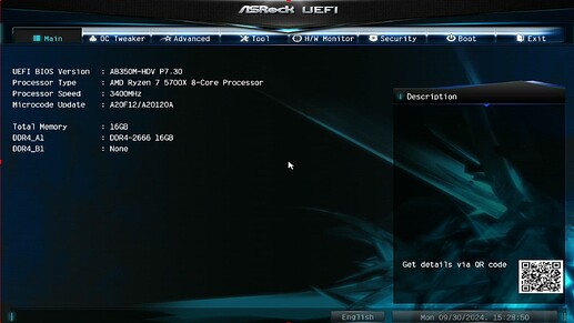

Well, if it is not a support issue, then BIOS is the most likely culprit, since I am 90% sure the CPU is fine (have been stress tested multiple times with no issues during tests with heavy load - and Windows also not complaining about it during CPU intensive tasks). I highly doubt the PSU is an issue, it is still relatively new and 650w or so, with no power issues on Windows (where my CPU+GPU+RAM are often being almost fully utilised - way more pressure than I’d usually put on Linux day-to-day), and my RAM is fine, it was before upgrading my CPU, and was fine during RAM focused stress tests after CPU upgrade. The only reason I came to that conclusion was because I only seem to be experiencing issues on Linux, no matter the distro or versions, and because I’ve seen the same issue happening on my friends PC, which as previously stated was fixed when he upgraded to EOS with newer software.
SVM Mode - Enabled
Power Loading - don’t think I have this option
CEC2019Ready - don’t think I have this option
ERP - https://www.overclock.net/threads/how-to-enable-disable-eup-erp-in-asrock-bios.1348389/ don’t have the options they seem to be talking about
Global C State - Assuming auto? Same issue as above
IOMMU - https://us.informatiweb.net/tutorials/it/bios/enable-iommu-or-vt-d-in-your-bios.html#asus-uefi-bios-blue don’t know if i have these “bridges” most posts refer to
I also included screenshots of my BIOS for your reference, feel free to request more
And also thank you (all) for helping me so far
You haven’t tried updating the UEFI Firmware (Bios) to the latest. I know they have two beta versions which is ridiculous. Why they haven’t put out the a final is beyond me. The fact is the last two versions have updated AMD AGESA. This controls the power functions of the motherboard related to the Cpu. I know it say’s you can’t go back to previous Bios version which doesn’t make any sense to me. But you also can’t with the version you have now. Personally i am not afraid of using a beta Bios. But it’s your hardware so it’s up to you. I just think the updated AGESA is important. Will it correct your problem. I can’t say. :person_shrugging:
I will then trust your input, I’ll update to the latest version sometime after the 18th (got some important stuff that needs handling first, so cannot risk a broken system), but then I’ll get back to you on it - for now I’ll keep trying alternative methods
