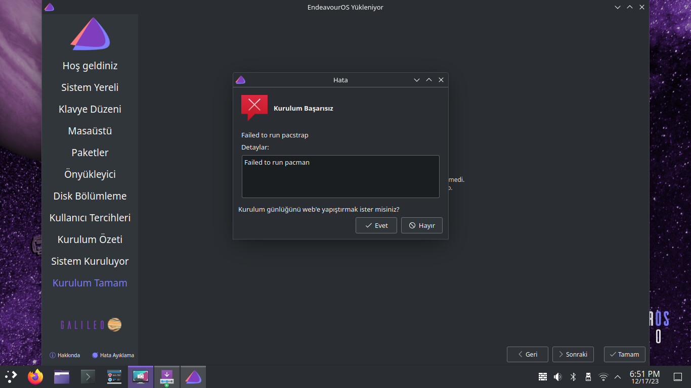

Hello bros, im a Turkish endeavouros user. First of all, I searched for a few linux distributions, but I couldn’t find the best one among endeavouros and decided to install it, I wrote the iso image to my 8 GB sandisk cruzer switch flash memory with an iso image printer, while trying to install the os, that gives me an pacman error. After that, I checked the mirror links and updated them, but it didn’t help, I tried writing with another application and before installing endeavouros on my computer, I downloaded linux mint and wrote it with the built-in usb bootable printer and tried again, again it didn’t help, I checked the mirror links and updated them, but it didn’t help, I tried writing with another application and before installing endeavouros on my computer, I downloaded linux mint and wrote it with the built-in usb bootable printer and tried again, it didn’t help again, my friends, I’m waiting for an answer from you right now​:wink:
Note: I use the online installer because the cinnamon desktop environment is easier and faster for me than Plasma KDE

Uploading: Screenshot_20231217_184312.png…
First its stuck at %13 and after that gives this error
I’ve seen this error before and all I had to do is use the update mirror buttons on the welcome app that first loads. Just be sure to reboot first before trying because usually when this error occurs it won’t work unless you reboot and update the mirrors from a fresh boot. Then try again.

Try to reboot and and before starting Calamares Installer open a Terminal and run:
sudo pacman -Sy archlinux-keyring
Hope this helps.
It worked after my 5th attempt, thanks a lot man, you are a good one
