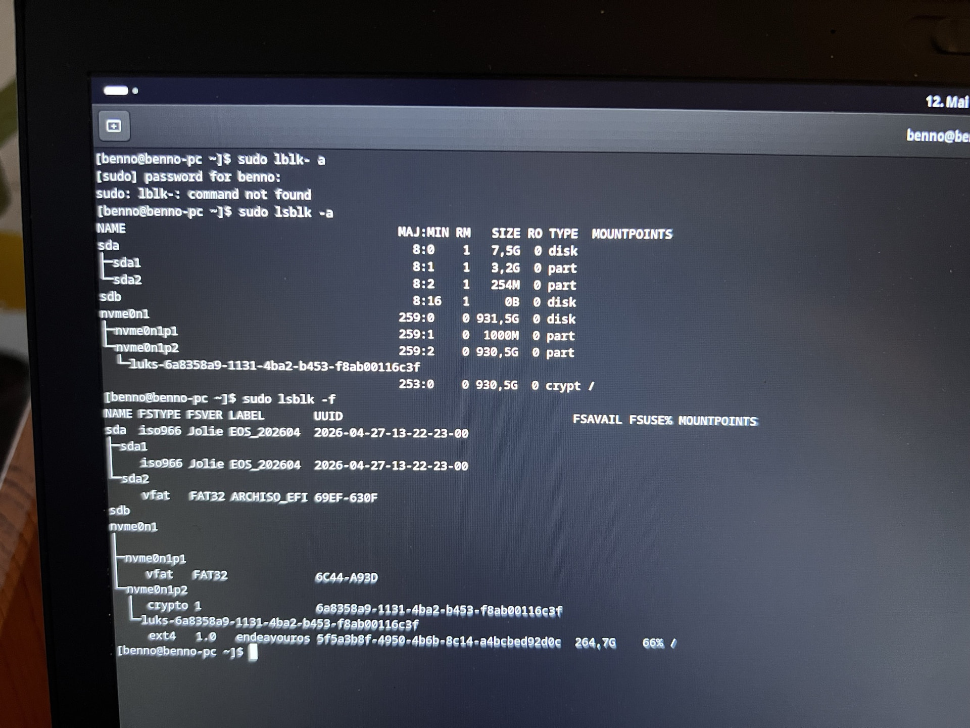

What’s the output of
sudo lsblk -a
Assuming this is the only OS on the device.
Thanks! I’m glad to be here, and usually really happy with my EndeavorOS, but this one’s a tough one!
Here’s a picture of the outputs. And yes, this is the only OS on the laptop.
Awesome, - so it’s detecting your drives consistently, which is good. The luks-encrypted drive is the bit that’s clearly failing over.
Can you boot from the live USB install of EndeavourOS and run
sudo cryptsetup open /dev/sdXy luks_root
where the sdXy bit is your actual partition, sorry not wearing my glasses, but I think that’s nvme0n1p2

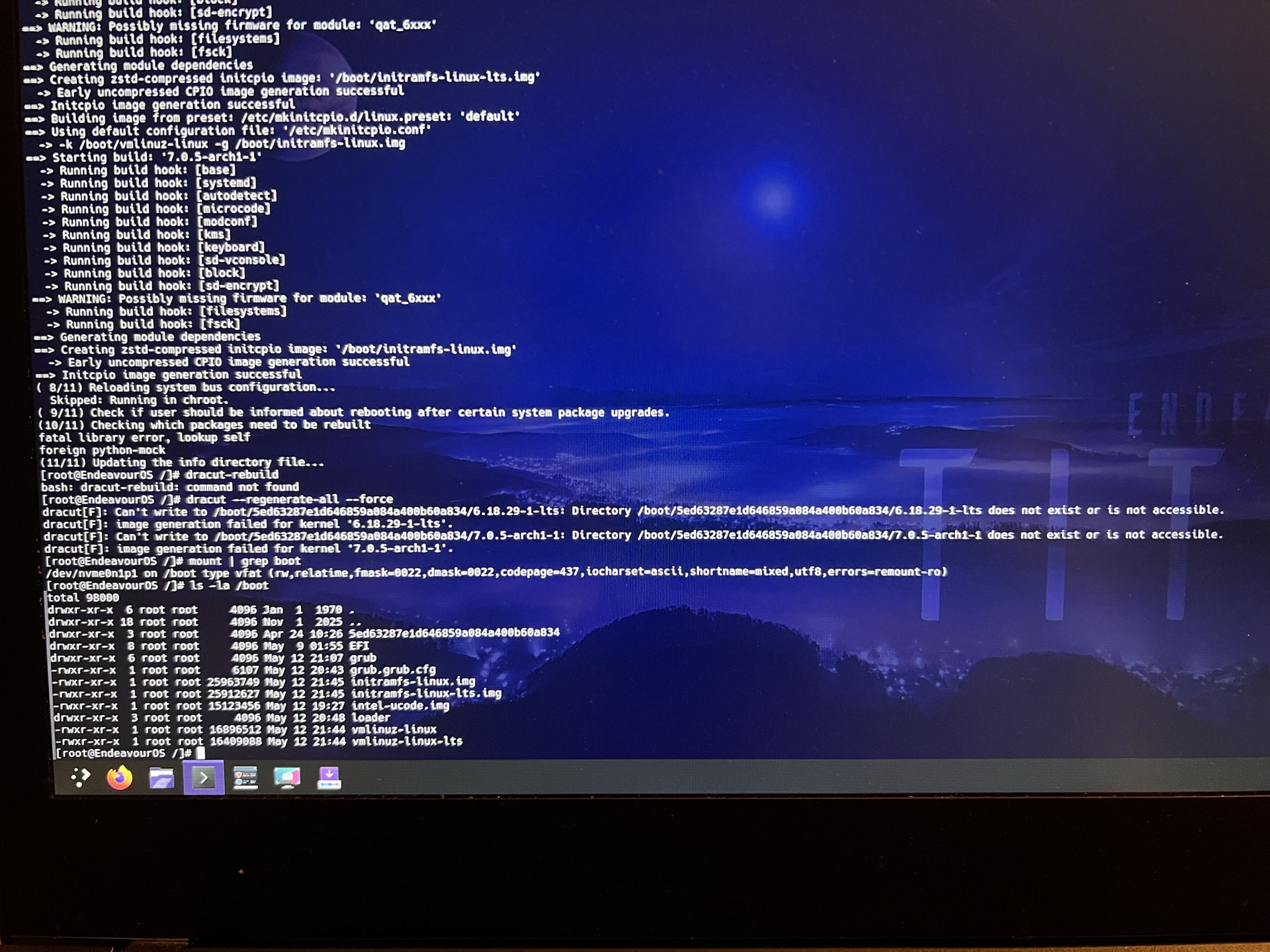

During rebuild I noticed
dracut --regenerate-all --force fails with:
Can't write to /boot/<machine-id>/<kernel-version>
Current /boot contents look like this:
  • normal kernel images exist:
    • vmlinuz-linux
    • vmlinuz-linux-lts
    • initramfs-linux.img
    • initramfs-linux-lts.img
but there is also a strange directory:
/boot/5ed63287e1d646859a084a400b60a834
dracut tries to generate images inside that directory and fails.
So now I’m wondering whether dracut config/kernel-install is broken, the boot layout is inconsistent or if EOS should even still use dracut here..
