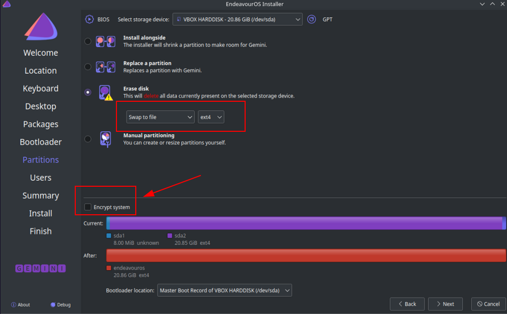

    • I missed the point where to specify the full FS encryption
    • I stopped the installation, when I realized and wanted to go back to activate, but that was not possible. (VM installation was with that enabled, but could not remember, where to enable)
    • I ended in partitioning tab with no chance to further go forward (as I don’t wanted to change something; “next” was disabled :astonished:) – only chance: deleted SWAP, then I could proceed the installation process (maybe this is a bug and is not intended)

not 100% sure what you experienced there… But if next is not working, settings are not complete… Like choosing to replace partition without actually choosing a partition you want to replace…
Automatic Partition has the option to “enable” encryption…
and easy options to add swapfile. or swap partitions including option to setup resume/hibernate.

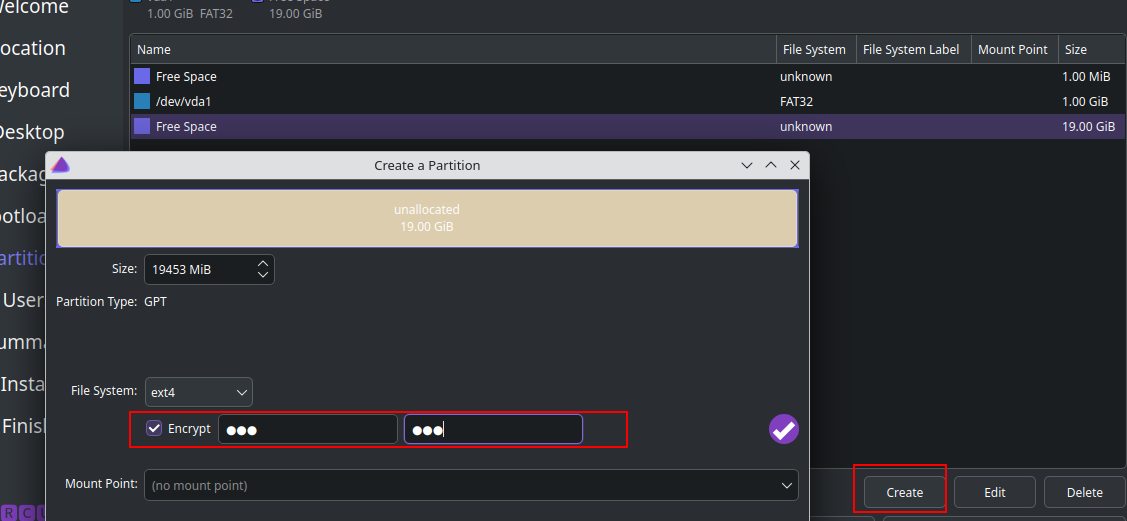

Manual Partition option has also encryption but you need to enable it for all partitions to use full encryption, you can’t encrypt the EFI partition.

TOP2 (next not working): I know: the error is usually in front of the computer - not inside. My excuse is the new display with great resolution, all dialogs in 10pt-fonts and my old eyes :wink:. So, it is very likely, that there was still something missing to complete the info. That was clearly the case for encryption of file system (you show it in your post; I found that in the Wiki, too).
