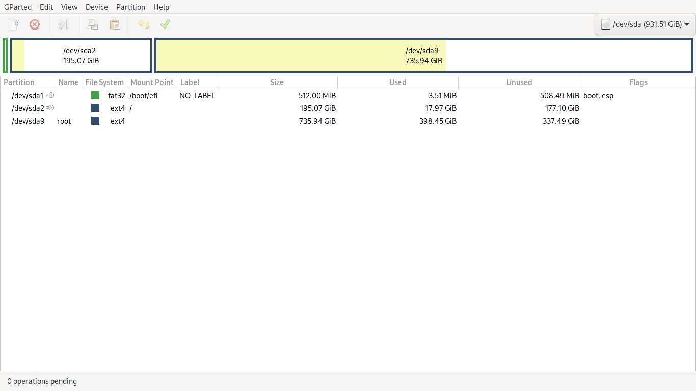

You could remove the partitions that have Arch and Eos installed using gparted on the live ISO and reinstall EOS.
(/dev/sda2 is arch, /sda9 is endeavour)
I meant to say i installed arch so i could temporarily use it until eos got fixed though i also fixed grub by reinstalling through creating a new efi partition since i had issues getting out of rescue mode and doing yay -S grub didnt solve it nor did other methods i found online. as for arch being more difficult to installed i used a gui script (https://sourceforge.net/projects/arch-linux-gui/) which lets you choose a de/wm to install. Thanks for putting up with my stupidity
