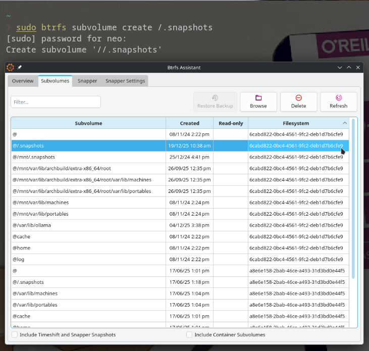

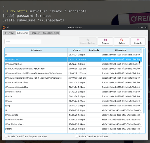

Yes, the other filesystem is of my HDD
Did you create the /.snapshots as described above?
It looks like you did not from the screenshots.
Wanted to confirm with you before proceeding.
Did now:
(sort applied on Filesystem column)
Can you take a manual root snapper snapshot now? You can do that in the Snapper tab.
Yes, I was able to take a manual root snapshot.
Extremely sorry for replying late.
Hoping things turn out fine on next reboot(will be doing in a couple of hours)
