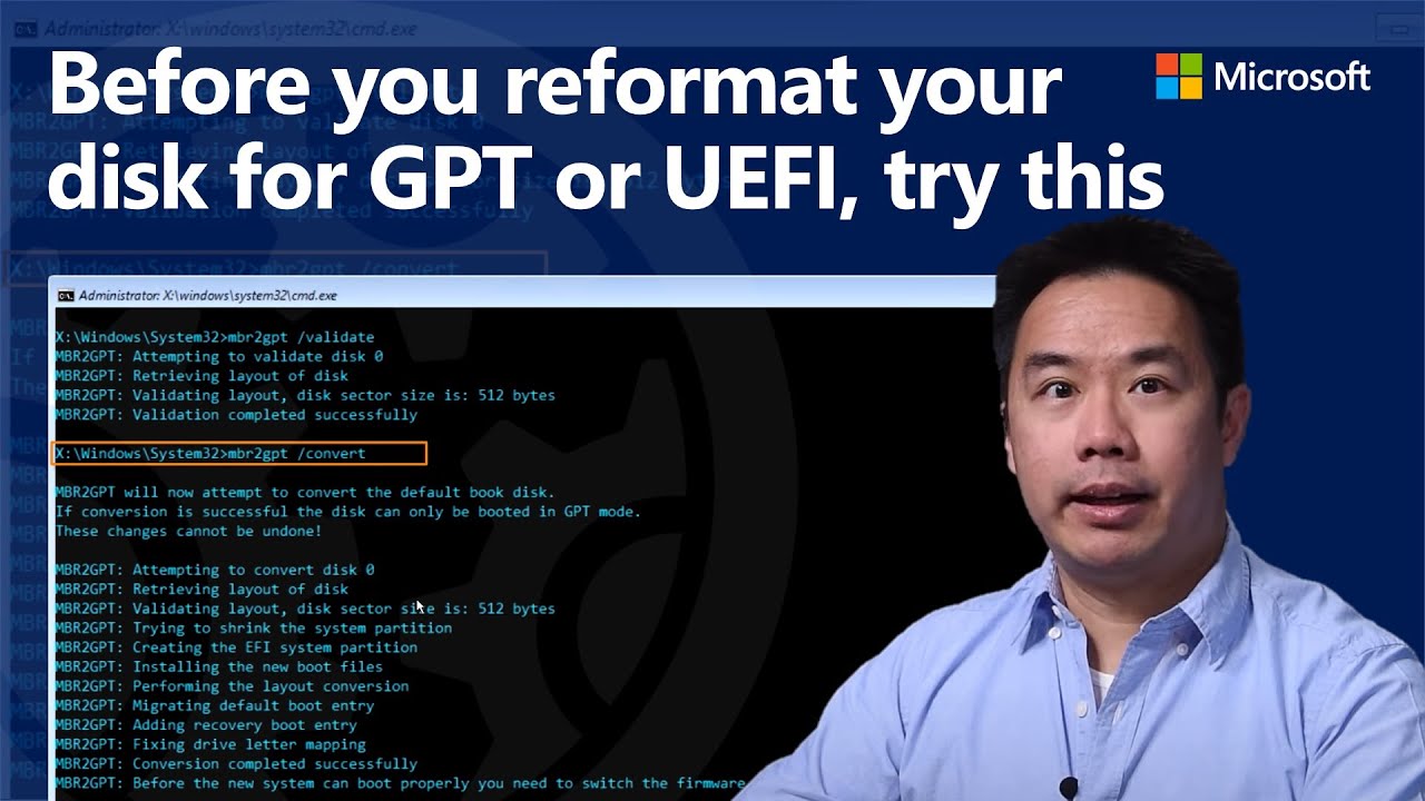

From some of the research I have been doing, it seems that the problem is the conflict between my legacy install of Windows 10 and Endeavour OS being more suited for an UEFI install. I found this tutorial on how to convert a legacy Windows 10 install into UEFI without losing data:
But first perhaps it would be worth trying to install the bootloader manually. Could I please have some assistance with that? I lack the knowledge in this field unfortunately.

Success! It looks like the conflict between the legacy install of Windows 10 and installing Endeavour OS was the problem. Changing the Windows install to UEFI and then installing Endeavour OS with systemd worked. Here is what I did in case anyone encounters a similar issue in the future.
(Hopefully you will not need it, but backing up important files would be prudent)
  1. Confirm whether your BIOS/motherboard supports UEFI. Converting a legacy Windows into UEFI with a BIOS that does not support it will probably make it unbootable.
  2. If it is supported, then use mbr2gpt to convert your installation without the need to reinstall Windows.
  3. After it has been successfully converted, you may need to turn off CSM in your BIOS settings. Also first make sure that you can boot into Windows after changing the BIOS settings. When you are able to boot into Windows, you can check if it is in UEFI mode via system information. If secure boot is enabled, you may want to disable it as it could cause problems with the Linux installation.
  4. Boot into the live environment as normal and install the OS. You will know if the live environment is in UEFI mode if the boot loader menu gives you the default option of systemd instead of just GRUB.
  5. If the install was successful then you should be able to boot into either OS via Linux (or rEFInd if you choose to install that later).
If your device is not compatible with UEFI, then unfortunately I am not sure how to solve this issue…
