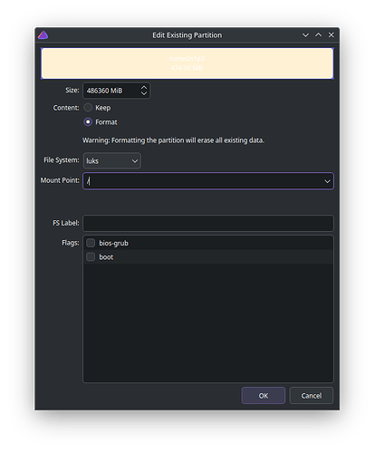

You can set up a separate boot partition, but you lose the option to encrypt the root partition if you choose manual partitioning.
Eh…you can just encrypt it in manual partitioning. Why would the option be lost?
It’s just not an option that I was able to find. I don’t know what else to say about it.

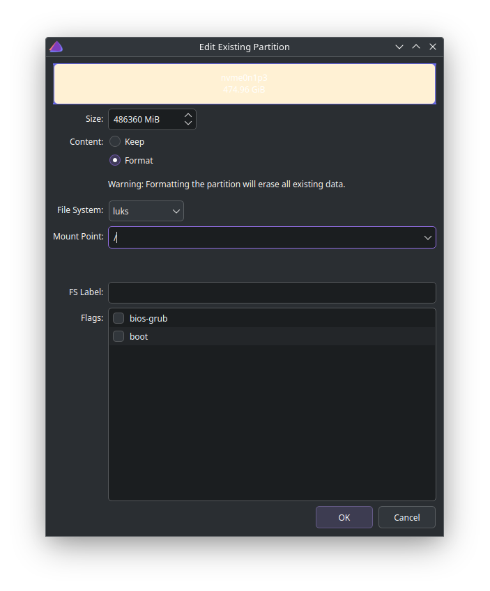

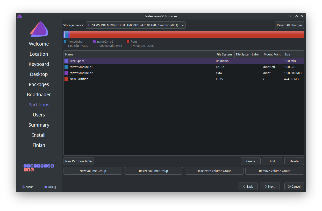

You can set the filesystem of the partition to “luks”, but that is obviously not right–there is nowhere to set a passphrase, and no way to define the actual filesystem that will be used when LUKS is unlocked.
Edit:
Here is what I am looking at:
You can set “luks” for the filesystem, but nowhere to set the passphrase or the actual filesystem inside.
The installer lets you attempt installing this way, but it fails.
Edit 2:

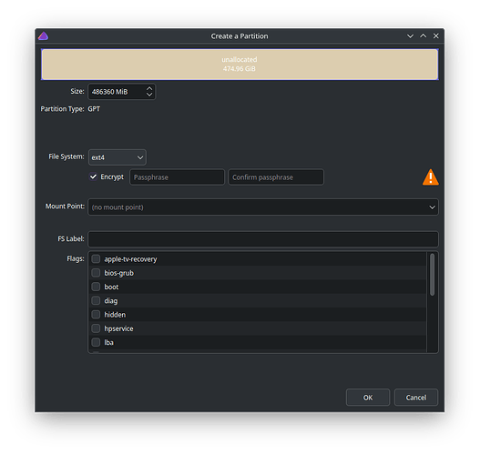

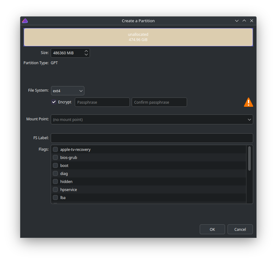

I just discovered if you delete the existing partition and then create a new one in the manual partitioning menu, you get a different set of options. :smiley:
You were right @dalto, my mistake.
You don’t choose luks there. You set the filesystem you want to use(ext4/btrfs/whatever) and then click the encrypt checkbox.
Yeah that’s what I was saying, there is no checkbox if you just double-click on a partition and tick the “format” option. But if you delete the partition altogether, then make a new one you get the encryption checkbox.
I’m not sure why I didn’t know that, I guess I have never done it before. :smiley:

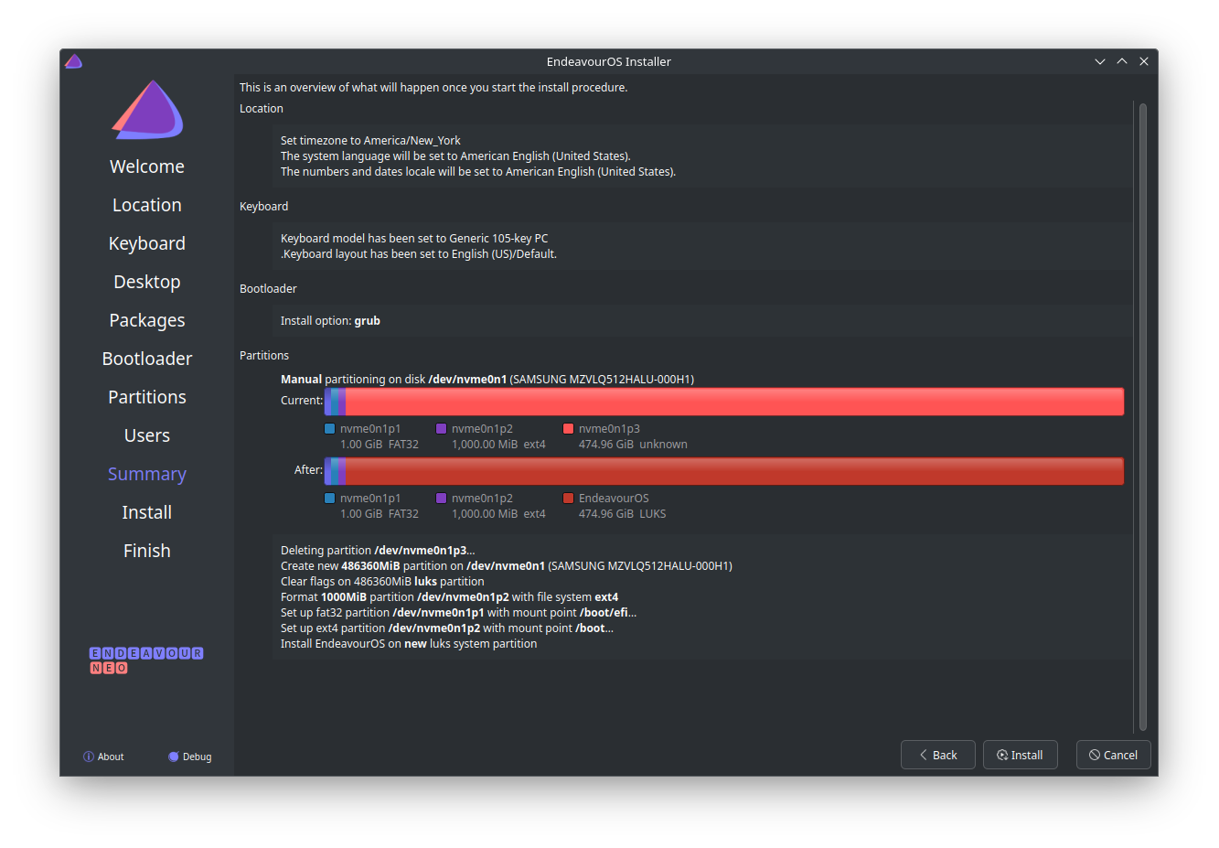

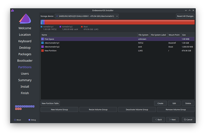

Tried it now, and yes, the menu does come before decryption but I can’t choose Windows. Am I supposed to be able to do that?
On the other hand, now it boots to HDD-installed Endeavour even with Optic Disk as priority (bootable ISO).
Don’t know if that’s VM issue or not…
But in theory the PC should boot into systemd-boot and show a GRUB-like menu where I can choose what OS to boot?
