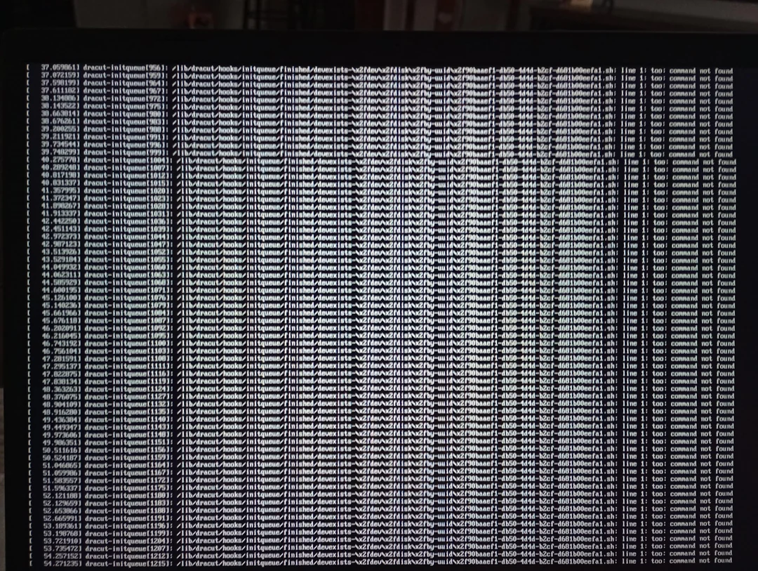

Whenever I boot, I get this for a while, before it switches to ‘too few args’. It eventually lets me into the emergency terminal, and when I cat the offending file, it also just says ‘too few args‘. Here is an image, I will answer any questions.
I have never ever had any Dracut bugs when booting using grub. Was the system up to date? Maybe try sudo dracut-rebuild

It is, and this command had no effect on the issue
Do you mean the contents of the file are literally the words “too few args”? I guess that would explain the error line 1: too: command not found.
Is there anything else in the file? If not, I would guess there was an error of some kind when it was created.
See if a package owns that file.
pacman -Qo /path/to/file
If something owns it, perhaps you can delete that file or move it to backup and reinstall the package.
This file only exists during boot, and I can only find it from the emergency shell.
In what context did you run this command? Most likely you will need to set up a chroot from the live environment before you run it.

Back to the original issue, @wyatt things like this are usually caused by one of a couple of issues:
- Corrupt files on the source system when the initrd is built
- A partial update is causing things to be out of sync(Either caused by holding things back in
/etc/pacman.confor a partially updated mirror)
I would chroot into the system, validate you don’t have anything in holdPkg and then so an update and run dracut-rebuild
