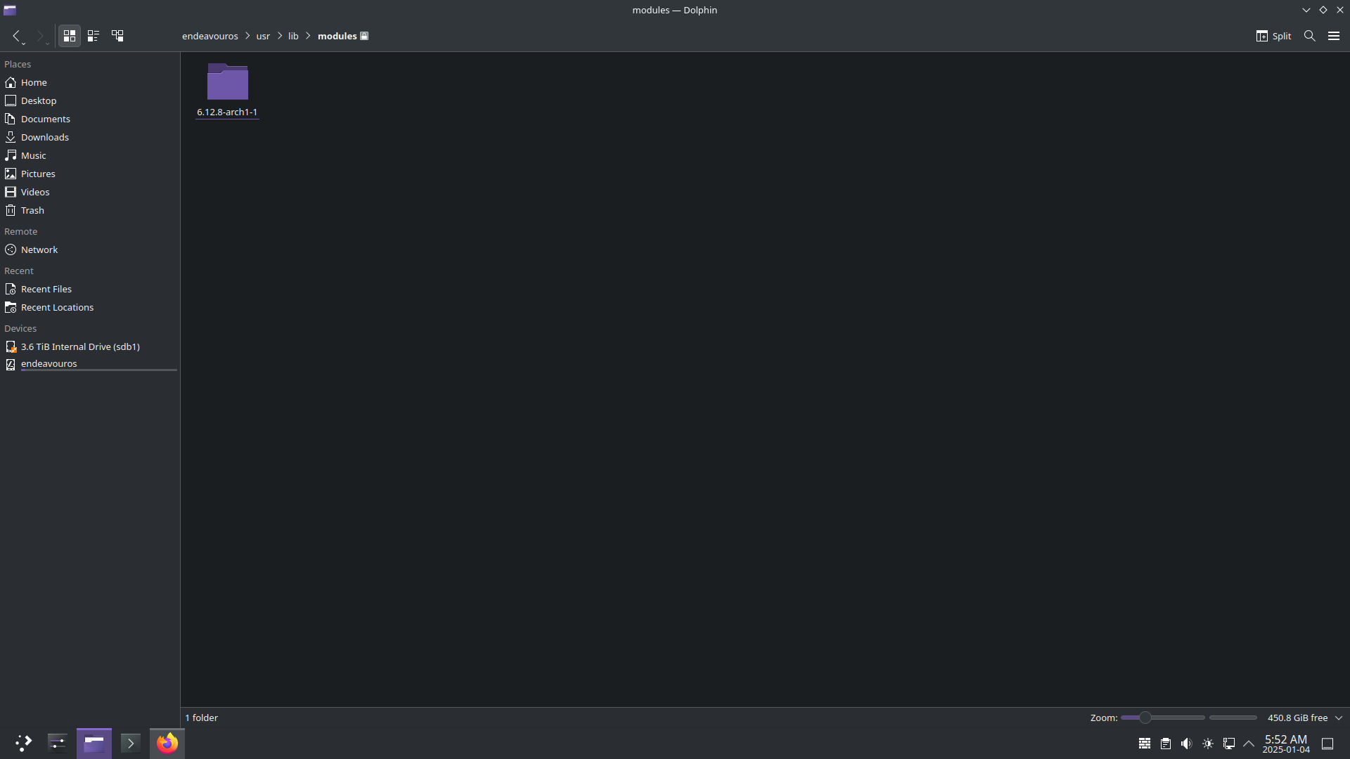

I do have the 6.12.8 installed as shown in the image. The problem I’m having is even though it removes the previous modules for older kernels dkms status is still reporting looking for them after they have been removed.
What do you still have in the following folders?
ls -la /var/lib/dkms
ls -la /usr/lib/modules

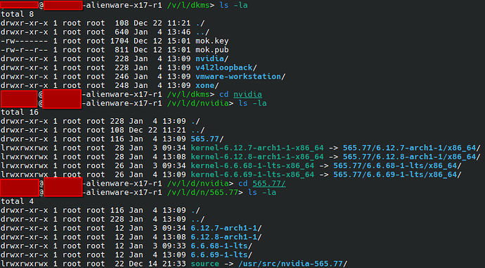

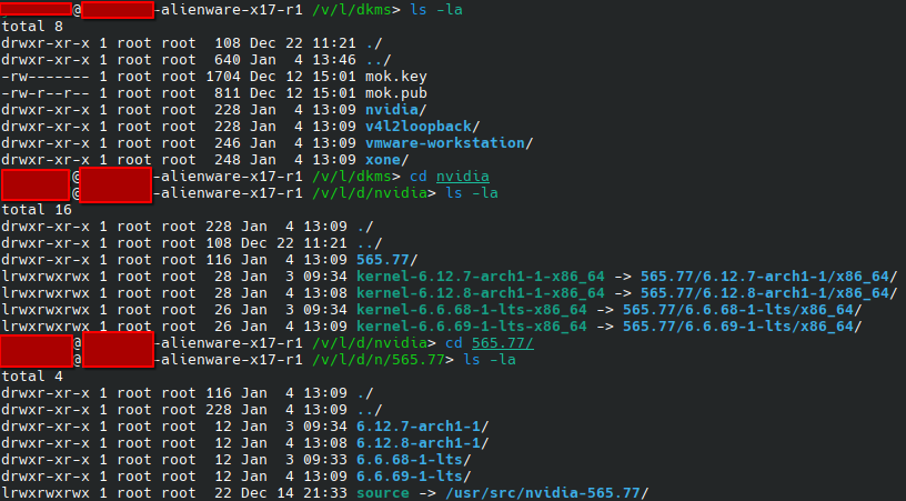

Can you check the subdirectories of the kernel modules? e.g. /var/lib/dkms/vmware-workstation/17.6.2_24409262 or whatever version number you have. The directories inside of here should only contain directories mentioning your current kernel version.

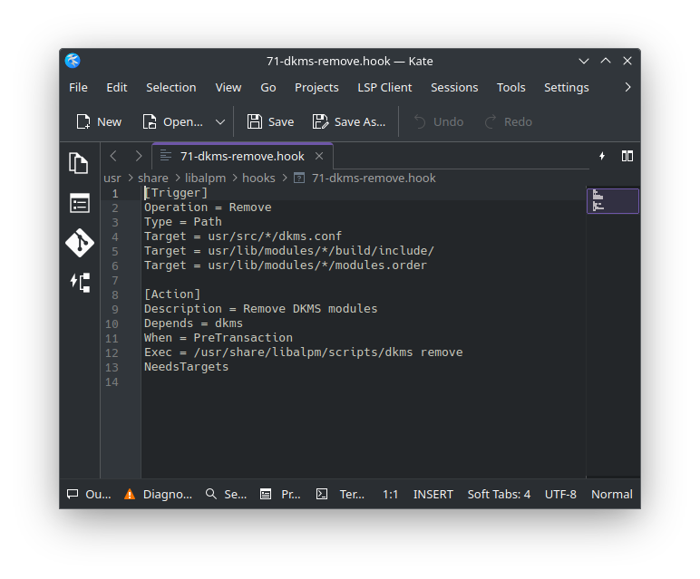

As far as I understand, when upgrading a kernel with yay/pacman, this hook gets triggered: /usr/share/libalpm/hooks/71-dkms-remove.hook, which executes /usr/share/libalpm/scripts/dkms remove. This script /usr/share/libalpm/scripts/dkms is maintained by arch (see e.g. here as the script mentions the name Sébastien Luttringer). But I’m having trouble finding any related issues like ours in the arch community.

Okay i fixed it now. Seems it has the files in two places. So i removed them from the folders of the packages that use dkms which are broadcom and vmware. Now i get the proper results. So I’m wondering what should be removing this stuff when new kernels are installed? As you said having to manually clean these up is not right.

Well, I would expect /usr/share/libalpm/hooks/71-dkms-remove.hook to take care of cleanup. But it doesn’t work, obviously. And it appears that it’s not related to arch as I can’t find anyone with these issues in the arch communities.

Unfortunately I don’t have anything to contribute, other than to say that I have the same issue. I can fix it temporarily by cleaning up manually, but when the kernel is updated, the problem appears again.

That screenshot of 71-dkms-remove.hook still makes me think that things are just happening out of order, i.e.
Step 1: delete installed modules directly.
Step 2: invoke dkms remove, which then fails as some of the files have been manually removed.
I wonder if you swapped those [Trigger] and [Action] sections around if it might fix things (or even remove the first [Trigger] section as in theory dkms remove should delete all related files to that module).
