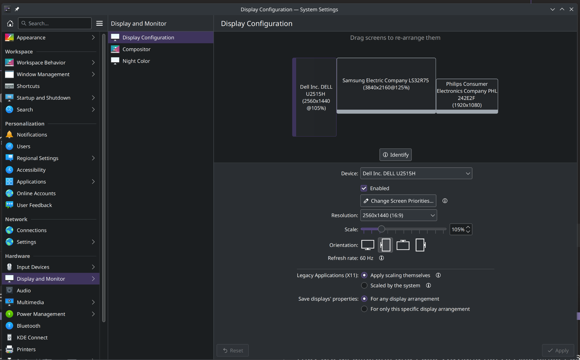

I have an issue after I put my plasma/eos machine to sleep and wakeup after. Sometimes one or two of my three monitors freezes on the logon screen and seems unresponsive. I still can login though, but the affected screens just show the logon screen. It only happens from time to time and is hard to reproduce… Any hints?

It can be a lot of thingssometimes. Are the monitors different or all identical? How are each hooked up? HDMI, DP? Sometimes it’s poor quality cables that don’t meet specs. Do you a have a multi-monitor file?
https://wiki.archlinux.org/title/multihead
They are all different, and I use Wayland not X. Also since I use wayland all of them have a different resolution set. Two of them are via DP and one with HDMI. Two of them (secondary and the third on) are connected via HDMI and the primary one is connected with DP. Do you think I should exchange the cables? Did not have this issue with any other distro yet… with the same cables…
