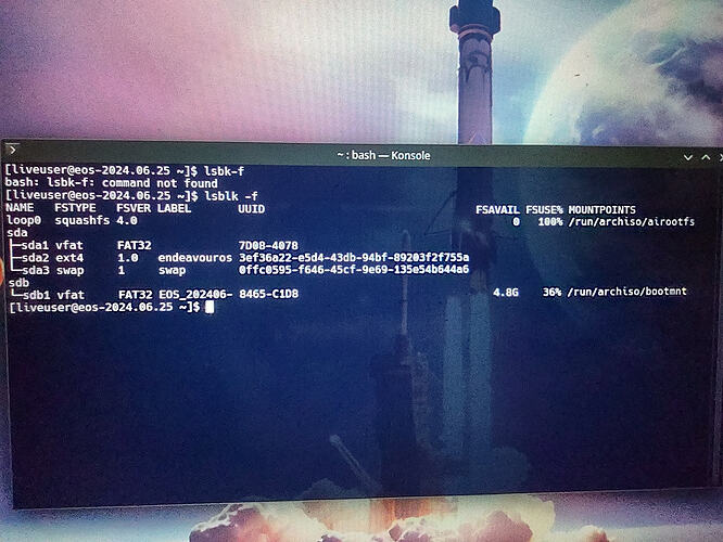

You might try booting with the EndeavourOS Live ISO, then running this and sharing the output:
lsblk -f
What we’re looking for, is the UUID for the drive you’re having issues with. It may or may not match. If it doesn’t match, that’s the culprit.

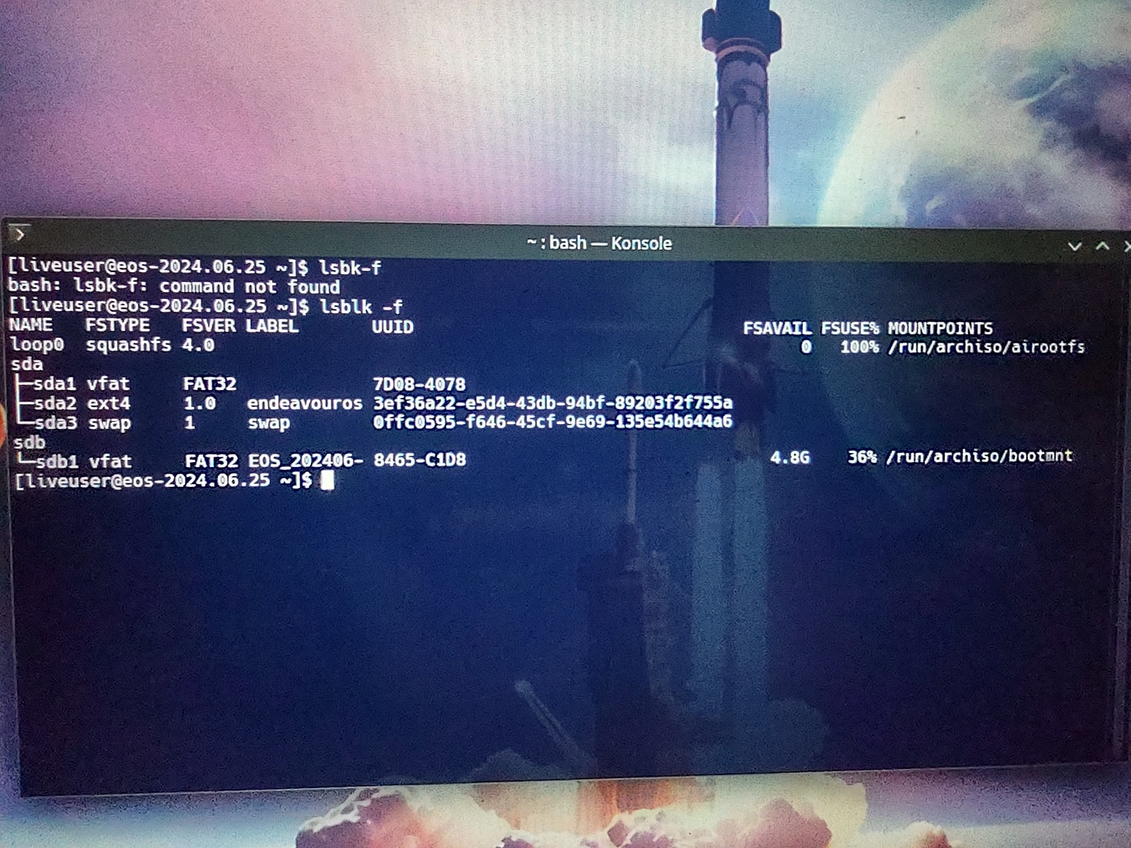

lsblk-f on the original iso
The UUID there, 3ef36a22-e5d4-43db-94bf-89203f2f755a, looks to match, so no issue there.
