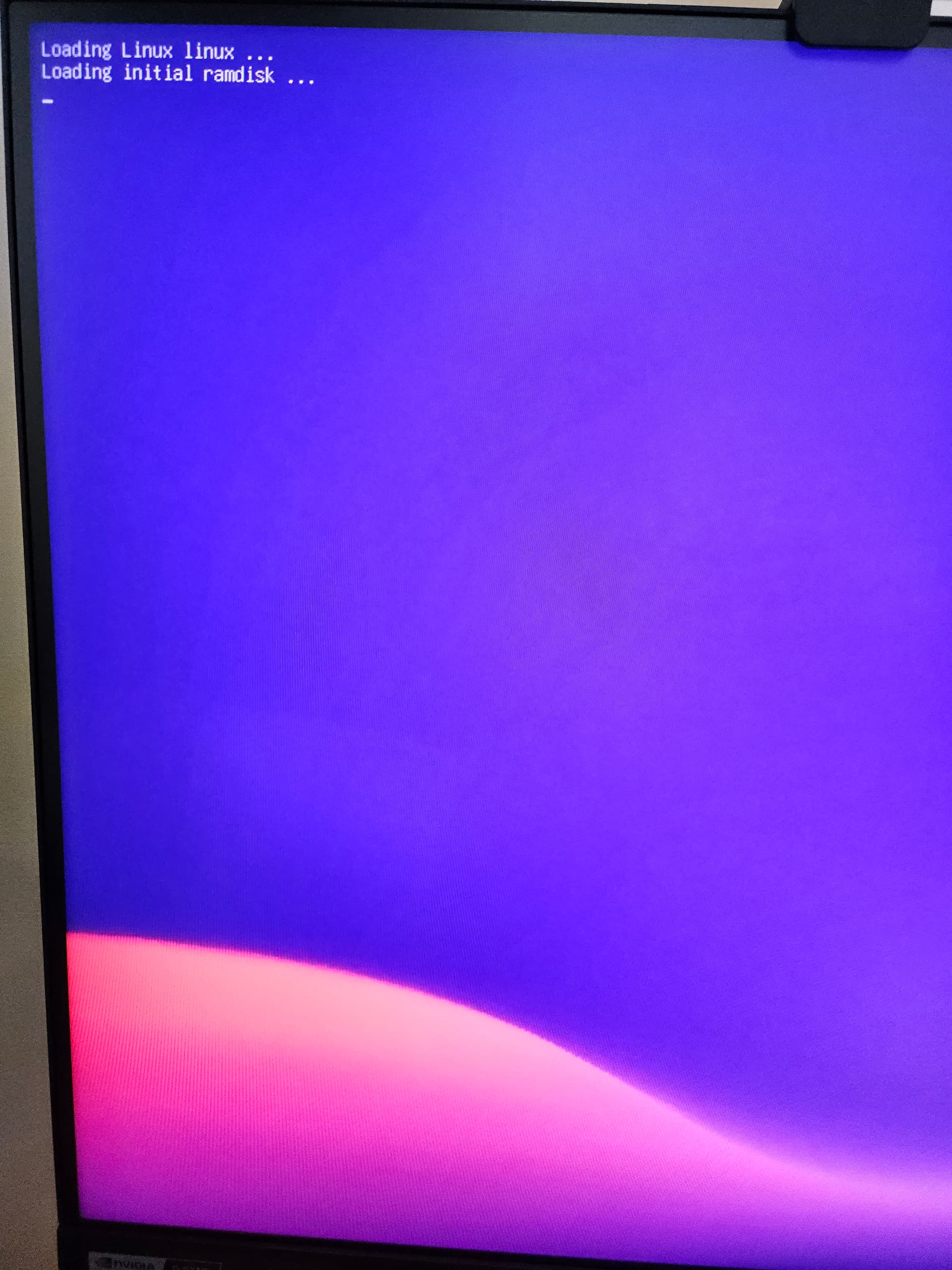

Cant boot back up after power outage took me offline
There was a fairly nasty storm last night and my computer was forced offline. I just tried booting up and it keeps freezing at this screen. Am I screwed or is this fixable?

Just before your response, I rebooted after the “check” in gparted, and it successfully booted in like normal. I checked KDE Partition Manager, and it shows the drive used/available properly. Should I still do these additional steps?
