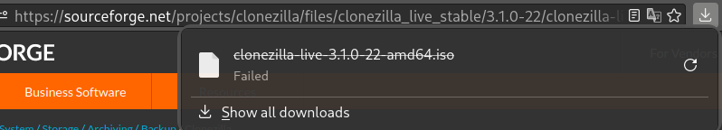

I can no longer download files with either Waterfox or Firefox. I disabled UBlock Origin as a test, but it made no difference. It still fails in the downloads list. The last file to download successfully was 27 September. Since this I have removed firewalld and installed ufw, but it did not help. What else can I try?

New default profile resulted in:
