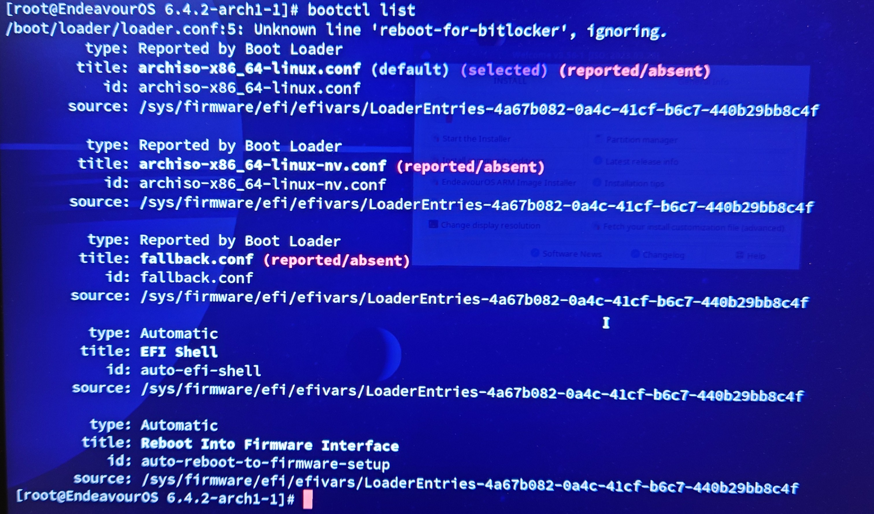

Further, I’ve attached an image of the output of bootctl list
It looks like you have your EFI partition mounted over /boot. Are you sure it shouldn’t be mounted at /efi and not /boot?
The issue is that reinstall-kernels is failing. That is what creates those entries.
Im sure it wasn’t/efi because if I mount it on /mnt/efi, running mkinitcpio -P gives
That may be because you ran bootctl install while you had it mounted at /boot
If you unmount /boot what does ls /boot show?
