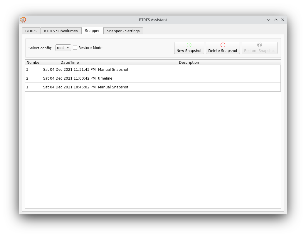

I enabled all those same as your first image.
When you update does it take snapshots?
That should be fine.
it will if you install snap-pac.
So when does it take snapshots then on it’s own?
Hourly.
Okay so how do you want me to test it using it?
Once you get some snapshots, you should try restoring snapshots and make sure that works.
Also, feel free to play with it and let me know if anything is broken.
Things are starting to get dangerous :sweat_smile:
So far i like it. I thought there was going to be a lot more to setting it up with Btrfs subvolumes and what ever because i know nothing about it. This will be good for users who want btrfs and snapshots because it is simple to install and set up now that i know.
That was generally the idea behind the application. To make snapper easy like timeshift but still have all the power and flexibility of snapper available.

Screenshot_20211204_233245
@dalto
Okay. What’s this? I think it’s it’s bug!
It say’s you have lots of free space, did you over buy?
I ran into the same issue the @ricklinux had with moving my snapshots from @snapshots to a nested subvolume under /. Once I deleted the snapshots and recreated a new /.snapshots subvolume, all is well. The interface looks really cool; coming from Linux Mint, I was used to how Timeshift worked, but Snapper is so much more flexible and this should make things easier to work with.

Since it is sometimes hard for me to tell if you are serious or not, I will just say, no, not a bug. :slight_smile:
Yes, the instructions in that post are wrong. I will look at them and see if I can figure out why.
Most of the functionality changes come from user requests. I am big on involving the community in the release and development process.
